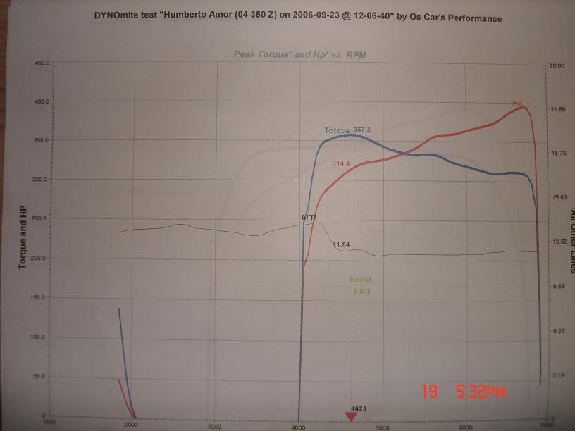

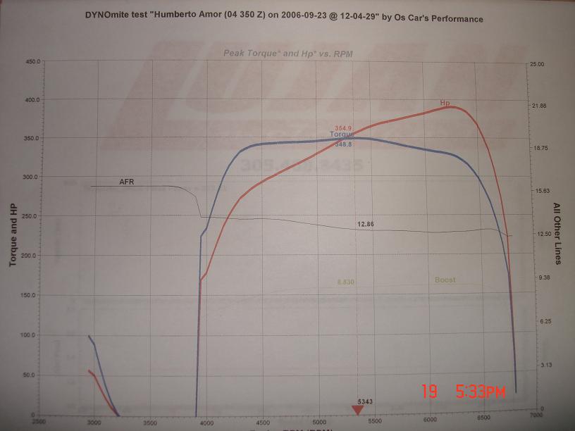

I have read that on a stock block VQ 3inch dual is to much and on top of that I have 3inch turbo back pipes and also w/g dumps so I don’t think it gets any more free flowing then what I have. I was thinking maybe if I restrict it a bit I might gain some back up top. here is my dyno chart. As you can see my power is solid and I don’t drop power at all but if you look at my torque its not that good in the first one its drops real bad and in the second one iT kinda levels out pretty much the entire way but drops a bit at the end. All I want in to kinda kept the torque going up instead on dropping or leveling out maybe a little back pressure would help. That’s why im trying to get the opinion on the shops guys and people that a know their S*** real well. BTW This is a dyno dynamite never heard of it but they told me it reads around 18 to 20 percent lower then a dynojet I think it reads I bit higher maybe around 14 to 16 or around that area. ANYWAYS PLEASE I NEED SOME INPOUT HERE IT WOULD BE GREAT THANKS.

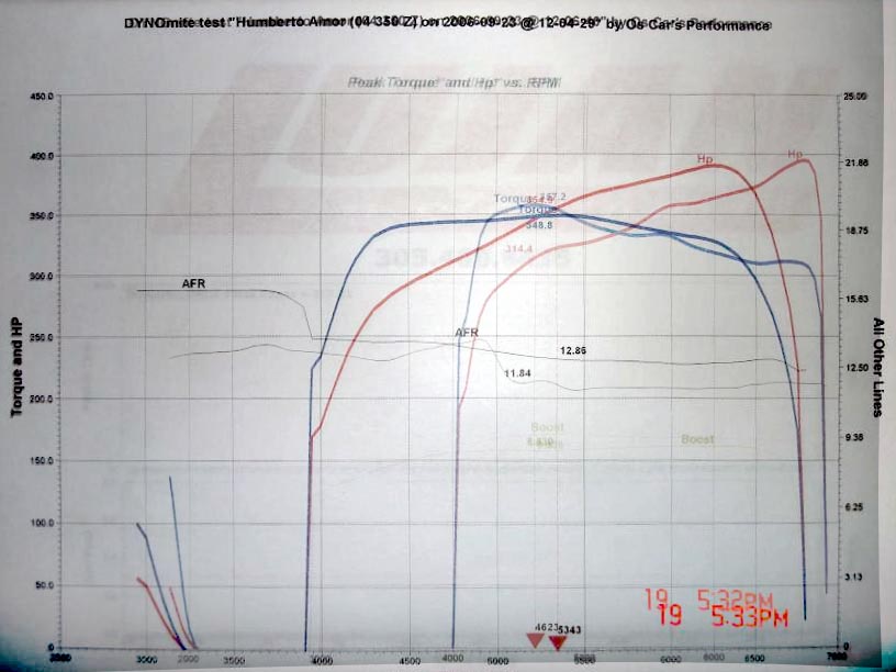

yeah dual 3 inch for just 400whp is not going to benefit you. The dynocharts prove that if it's truely a before/after dyno. That's a 40tq loss for most of the powerband except maybe above 6500 rpms
here's an overlay...

No No its the same day but two passes in the dyno i dont know why they came out so different maybe the first one was done at 4th and the second one done at 3rd thats why maybe my torque curve was so much better in the second chart then in the 3rd cause in lower gears you have more torque.
