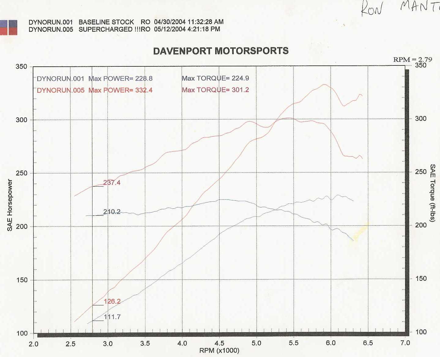

first one i hope these turn out ok

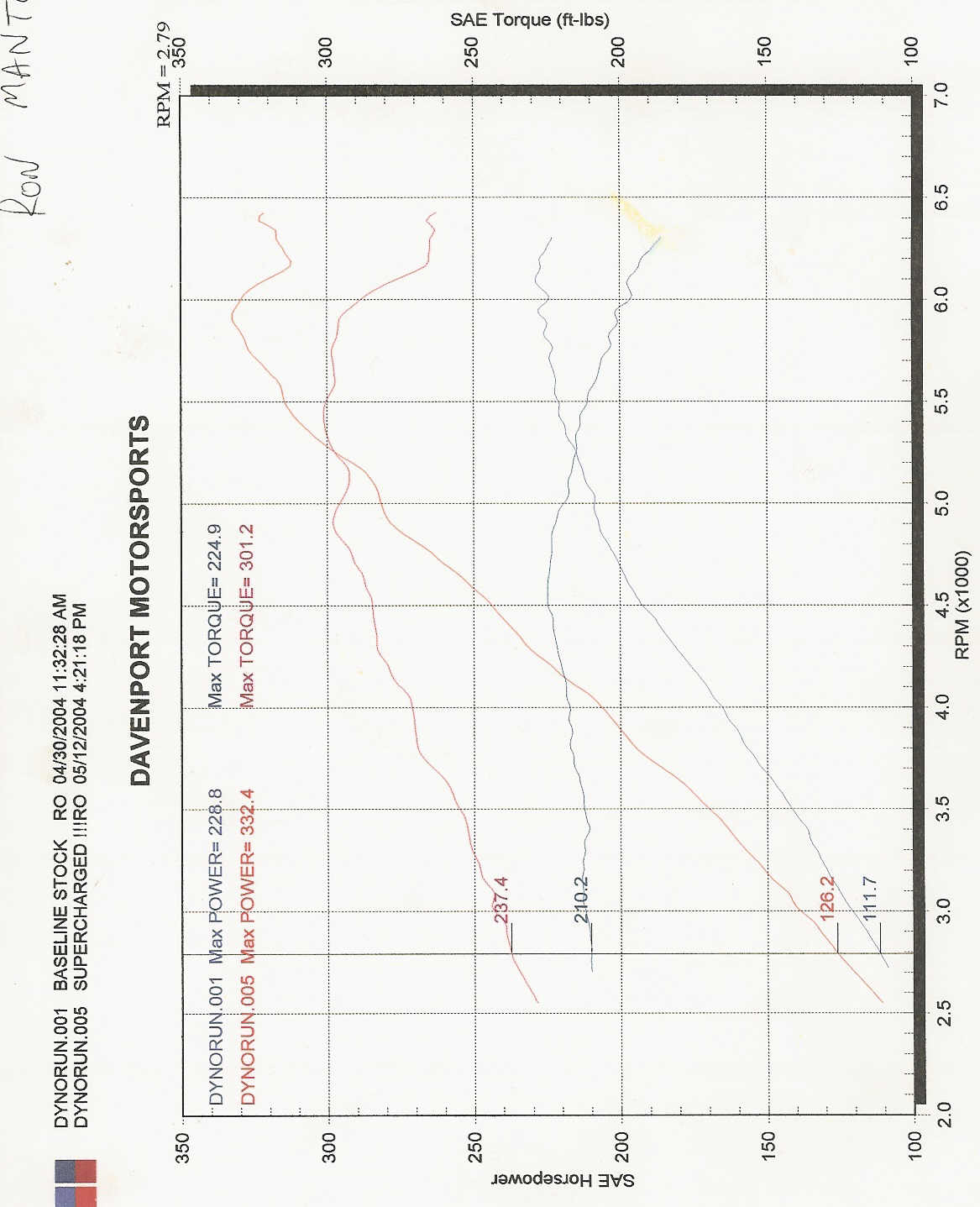

Upright pic

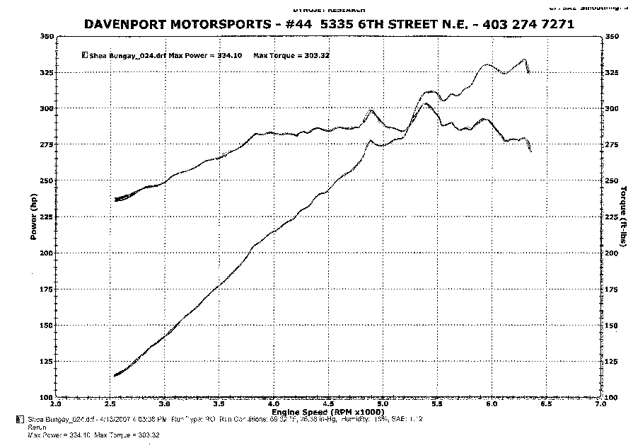

Current dyno

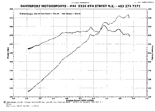

Better view Current dyno

Old Apr 15, 2007 | 06:08 PM
scshay's Avatar
scshay
Posts: 120
From: canada
Originally Posted by MRC Motorsports
This whole thing makes no sense to me..The Vortech supercharger Comes with a FMU capable of 400hp of fuel and an out of the box tune that should put down 330-350whp.
You need to find out what you paid for..What FMU do you speak of, did the add.
And did the tune the R4 splitsecond box or not..a 9 psi pulley even on an ultra conservative tune, would make 370ish with your mods..
Also I call foul on this entire thread until we see Dyno graphs..
i have put up the dyno graphs now i hope they help, thanks alot guys for trying to help me figure this out.
Old Apr 15, 2007 | 06:16 PM
Triji's Avatar
Triji
Posts: 1,220
From: The Valley, AZ
Ok at 5700 - 5800 rpms you are loosing tq and hp in hurry... Could be a rich condition up top which would point to your tune.
do you see at 5800 rpms where your lines start to degrade? ... Your tq should at least stay steady and your hp should go strong until redline imo...
Old Apr 15, 2007 | 06:52 PM
  #38
scshay's Avatar
scshay
Posts: 120
From: canada
ya i noticed that your saying it could be a little rich/
the hp stays up there though is the good its just the tq?
Old Apr 15, 2007 | 10:10 PM
  #39
Triji's Avatar
Triji
Posts: 1,220
Your HP drops sharply right there as well and then tries to raise again... IMO it should not drop at the end like that. Your hp should keep raising at a steady rate without that dip up top either.
Old Apr 16, 2007 | 03:51 AM
  #40
Julian@MRC's Avatar
Julian@MRC
iTrader: (28)
Posts: 5,510
From: Spotswood NJ
#1) You did not need a new $300 Billet Fuel Pressure Regulator
#2) your car is not tuned properly, there is 50-60 HP left on the table
