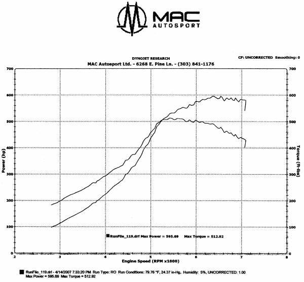

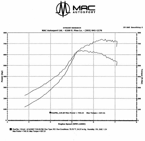

Kevin's Dynos

Thanks Sean
left side is uncorrected
right side corrected

How much boost was this at btw.

Originally Posted by r@mon
so basically it made 600whp... because the correction factor on the corrected graph is 1.24... that's a HUGE correction factor. How much boost was this at btw.
Oh no..............here we go...............
SAE correction is standard on DJ's. Kevin is up in the mountains so to simulate sealevel numbers the DJ corrects it to Sealevel.No trickery, this is the standard.
SAE correction should NOT be used at elevation on a forced induction vehicle. Weren't you a part of this discussion before???
