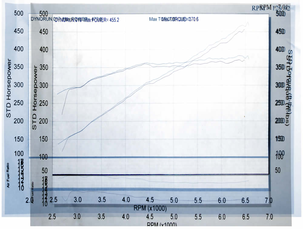

here's my low vs high octane maps overlayed where the high octane map has more timing and slightly leaner A/F. It's not really a dramatic difference, but it does bump things up slightly. If it wasn't for that little spike (which might be a slight dyno error) at the very top of my 477.8whp run, the chart probably would have read as 465 whp. My low octane map stopped just before 6500 rpms. It would probably have been 460whp if taken to 6600 rpms.
If my engine would rev past 6600 rpms to 7000 rpms, it'd probably hit 490-500whp without much problem. If someone was so inclined, they could also switch the 32 tooth cog pulley to a 34 tooth pulley to gain another 20whp or so, but I'm probably not going to take it that far on the stock block. IMO a stroker kit with headwork and better valvetrain to rev to 7k rpms along with the 34 tooth cog pulley, and keep the 10.3 compression ratio, you could get around 600whp and 450tq without the need of a T-trim. The engine's natural power and higher reving would be mainly responsible for the increase in power

wow, nice...great info
