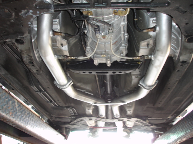

when I got my 3" exhaust they were none available so I had a shop custom make mine with 3" test pipes. I am using HKS TI muffler. The mufflers were $500 for both and the exhaust and test pipes came to $600.
Attached Thumbnails Questions after reading Sentry's Vortech thread...-3-inch-exhaust-003.jpg
That looks like a nice exhaust.
