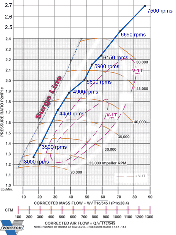

I thought I'd post up what their compressor chart would probably look like based on Booger's logged psi numbers with the cog system since Dsport hasn't posted a boost chart. Obviously Dsport had a larger exhaust and more headwork than Booger, so the chart might actually be slightly lower than how it's graphed here, but not by much
They were shooting for 8000 rpms, but had to pretty much stop at 7500 rpms making something around 25-26 psi and then promptly snapping a belt
if you chart that out on the T-trim compressor map, you can clearly see that it's outside of the T-trim's most efficient range the entire time. It's probably somewhere in the neighborhood of around 68% most of the time, except possibly at the end where it might be 67-68%
If Dsport was able to reach their goal of 8000 rpms, you can bet the efficiency % would be even less, like maybe 66%
The T-trim's highest efficency is 72%
72% even compared to 68% is a 5.8% improvement or in this case about 25whp worth of power on the table going from 68 to 72% efficiency
What it looks like to me is that if Dsport could get the car to run all the way to 8000 rpms, it wouldn't really improve power much at all compared to 7500 rpms. It'd pretty much start capping off as the blower starts blowing hotter air as it runs into lower efficiencies. Of course they were spinning the blower pretty fast too which starts building up more heatsoak over time. 7500 rpms actually brought the plot off of vortech's chart and I had to expand the graph to show it. 8000 rpms would be even further off the chart.
As interesting as what they were doing was, after plotting it all out, you have to wonder just how much they thought things out with reving so high with so much boost on such small belts
If they ran this setup on a larger engine or toned the boost WAY down, the entire chart would pretty much lower itself and move further to the right as it brings the T-trim back into its most efficient range. The boost pressure would go down and overall airflow would increase due to the larger displacement
IMO I do agree with Dsport and Booger that if they didn't try to overdrive it and rev so high, they'd have a better and more reliable setup. Hell, it might even make similar power levels compared to reving it so high etc since it'd be treading closer to 70% efficiency the whole time instead of 66-68%
by contrast, my car's S-trim when plotted out is treading around 71% most of the time

I haven't read the new article yet, but the rule of thumb is is that every 14.7psi you make, you double your power. That is under the assumption that the timing, intake temps, exhaust velocity, etc are the same as they are NA. Chances are Dsport was pulling some timing compared to a bone stock G35. Also there's the efficiency of the blower/turbo to consider
As interesting as is what they were trying to do, after plotting it out, I have to wonder just how much this setup was thought out or if they just figured they'd throw a T-trim on and spin it really fast on the VQ35 reving to 8000 rpms on a belt setup similar to the ATI that is notorious for breaking belts
IMO I do agree with them and Booger that if they didn't try to overdrive it and rev so high, they'd have a better and more reliable setup. Hell, it might even make similar power levels compared to reving it so high etc since it'd be treading closer to 70% efficiency the whole time instead of 66-68%
LOL !!!!! And your point is ????? You think that running a few %'s more efficient is going to make your blower make that much more power ? Or you can double your N/A power with less psi ?
And I expect no less than a 1 ft. long reply from you too. So get typing...lol
Oh...and make sure you include some more of your ricer math !!!
