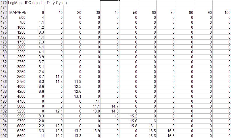

I am currently bored with my 3.12 pulley setup and sick of being stuck at a 13.1 so I want to pull the trigger and buy the 2.87 pulley.
I have a walbro and the CJM Stage 1 fuel return along with RC 440cc injectors and UTEC.
on all of my runs, the MPS Data Logger says my Injector Duty Cycle is only at 19.5 % (unless it is wrong) and i think the top feeds are safe at up to 80% duty.
Does anyone on here run this setup or do you think it will be safe for me to run it?
Thanks

19.5% doesn't sound right
well heres one of my logs

what's your FP @ idle on your FPR?
~53 psi

Originally Posted by Blackbird CPV35
~53 psi
with the vaccum line hooked up? That's high. Which explains why your injectors aren't working as hard.
crap, i knew i did something wrong lol
i measured my base fuel pressure with the vacuum line in

haha i guess i have to wait then.
and i found out that the injector duty isnt in percent on that datalo, its in MS. Even then it still might not be acurate
