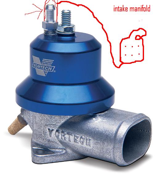

I'm coming up on this part of my install tomorrow. Where does the BPV hose connect to? Anyone have pics?

From: never never land
you put the hose from the top of the bpv, to the intake manifold. your kit should of brought a T-fitting that goes to the fmu as well.boost gauge/ vortech s/c???-bpv.jpg
