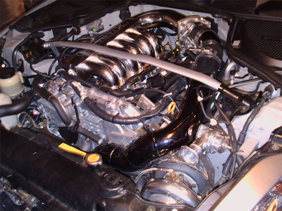

Don't think this was really what you were talking about but here it is anyway...

Just wondering why TN went with placing the turbo on that side... due to MAF sensor location and the coolant/washer fluid tanks on the other side?

why do you need a specific "turbo" manifold? The twins need them for fitment reasons, but really a manifold is a manifold - yes I understand some flow better than others. If you are running a single turbo, the oem manifolds will do just fine. Just need to route the two banks into one. Both APS and TN found two different ways to do so
