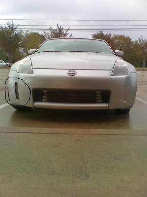

^^That's what mind looks like...had to mod the bumper too..

Here is my setup, this will not work with the OEM bumper cover, but just welded some custom brackets to hold the Earls cooler and then used an Earls sandwich plate with a custom made center post to mate it to the block. I have since removed the Greddy power steering cooler (piece of junk IMO) and located the OEM PS cooler like the turbonetics kits in the passenger fender well.
