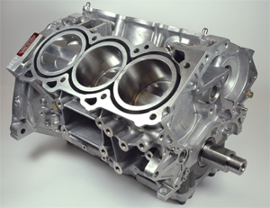

Do sleeves also cause an NA motor to run hotter? I guess it stands to reason that they would. I don't really understand why sleeves increase the temperature of the motor. All the block material that is removed is replaced by the sleeves.

the sleeves make the engine closed deck instead of open deck. Instead of the coolant completely surrounding the cylinder chambers, with sleeves, they only have little channels the coolant can flow through.
They're also not made of aluminum, but steel which traps in more heat
So you're saying that when they bore out the block for the sleeves, the outside diameter of the sleeves is so large that boring the block for it removes some of the water jacket that normally surrounds the cylinder?
I'm not sure what open/closed deck means.
just look at some shortblock pictures of a stock VQ35 and some darton sleeved short block pictures and you'll see
Attached Thumbnails Question about 3.8L motors-1169439374.jpg   Question about 3.8L motors-t_16225_01.jpg
