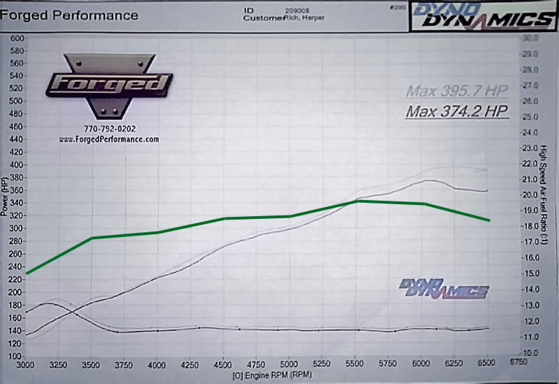

tq curve would look something like this when converting hp to tq for the more aggressive map
I just did it ever 500 rpms

ya Sharif is waiting on the software upgrade. When thats in, i;ll have torque #;s. it makes alotmore booost at lower rpms. Thats Sharif opinion of the kit compared to the SC blower. I was pullin almost 15psi at redline. But Sharif thinks that alot of manifold pressure that doesnt make HP. Poor flowing heads and a small injen xhaust will makre more boost but no HP. with a Greddy TT exhaust I woulda been easiyl over 400 on the DD (ie 460 plus on a dyno jet with pump gas
either way, new ECU doesnt fix the problem according to Sharif, so it might be the harness that shorted like was mentioned. Holy **** thats a ton of money!!!!
