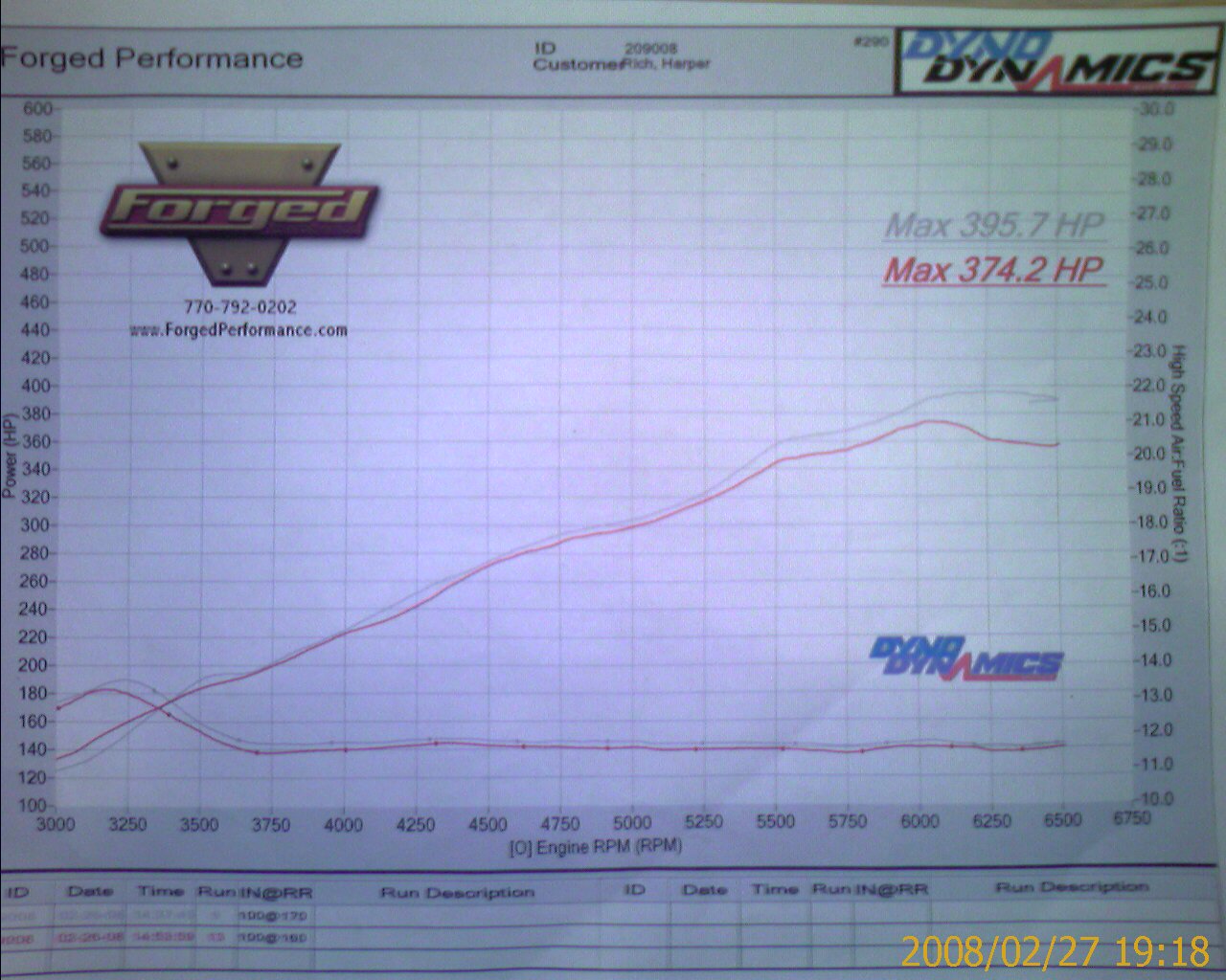

i dont have the dyno charts and Sharif's torque wasnt working. so i dont have all the #'s to post. only 396 hp on a DD

You should be in the 440-446whp range on the dyno jet, pretty impressive #'s for the Si-trim.

my #s were solid. Sharif said it was the fastest vortech he's driven. ive got a nice graph of air intake temps vs hp. you can see the AITs really spike. over 42 degrees C. Not critical during the winter but def might cause knock during the summer. Although, in my case AIT is much lower than graph bc of the alky injection. Sharif said thats probably why I have no knock.
2 maps. one full power one safer so if i run out of meth (camera phone pics, sorry)
ya the thread title is off, bc when i posted i was thinking off all the other extraneous issues everyone else has been having coincidently with the Si.
I cant edit the title myself.

42 C is considered high for air intake temps? That's around 107 degrees F
usually air intake temps are 20-25 degrees F higher than ambient
what was the ambient temp there when it was dynoing?
what psi?

what was your max boost during the dyno pulls? i was hitting 12 at 5500rpm, hope not to go over 13 at 6600rpm. man do i wish there were some tourqe number's on your graph. that's were i think the Si-trim will show some improvements over the Sc-trim. so far from what Sam has seen i think this will be the case... i was making 380 rear wheel tourqe at 5500rpm before the cog belt blew off with alot of timing pulled out and running very rich A/F's.
