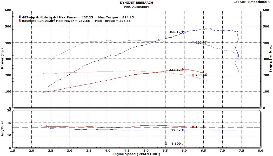

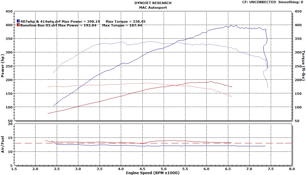

First I don't want this to become another Dyno vs Dyno battle or discussion on my AFRs. I will be having the car retuned at SGP in Houston when I return to the states. Please only post info that is useful. Thank you.
I've been playing around with some math and my DynoJet numbers. Going off of a 1.23 CF for elevation I made 487/414 & 398/338 uncorrected. I beleive most dynos use a 1.02 CF at sea level. If that is the case I took 398 x 1.02 = 405whp & 338 x 1.02 = 344wtq (405/344 w/ 1.02 CF). Also this is on 6.5psi (6.7 peak) per the UTEC reading. Which from my understanding is the manifold reading.

That sounds like a more reasonable amount for that boost level. Still impressive.

I think what would be helpful to clarify is whether the psi reading is based off of a 14.7 atmospheric baseline or off the baseline at your current elevation. It sounds like it's based off a 14.7 atmospheric baseline, which would mean it's already corrected for elevation since you don't live at a 14.7 baseline. In other words, the compensation is already built-in and no additional dyno CF is needed.
If you recalibrate the MAP sensor for your elevation, I think 6.5 psi would net you less power, in which case a higher CF could compensate.

Since I did not do the install, nor home (USA) when the install was completed I can not tell you if it was recalibrated or not. However... I'm gonna go out on a limb and say it was not. I do know that due to elevation we usally run between 1 to 2 psi more than at sea level.

Uncorrected is the "truth", what more do you need?

CF doesn't have anything to do with elevation, well not directly at least. It is used to compensate for variations in humidity, temperature and barometric pressure. This enables numbers from different cars, places, climates, etc. to be compared and reasonably accurate.
CF of 1.23 is completely absurd. That means that the numbers are 23% higher than the uncorrected numbers. I haven't seen a legitimate CF of higher than 1.06 or lower than .97. CF of 1.02 is very reasonable.
As for uncorrected numbers being the "truth", I would disagree. Uncorrected numbers merely represent what a vehicle put down, that day, at that time, in that place, on that dyno, under those conditions. IMHO, that's hardly representative of the car's true power.
CF should be preset on a dynojet anyway. There are 4. SAE, STD, DIN, and EEC. SAE should be the default and adjusts the CF automatically based on current weather conditions at the dyno. If a dyno operator or shop is putting in correction factors manually I would be very skeptical about the integrity of the numbers.
Hope this helps.
Edit* After re-reading your post I'm not sure I answered your question. It's possible that the weather station the dyno uses to adjust the uncorrected numbers to SAE is not working properly. It is also possible that the shop has gone in and adjust the conditions that determine the SAE correction factor. ie, instead of temperature being corrected to 70*F, they changed it to 60*F, which would give higher numbers. The same could be done for humidity and baro.
