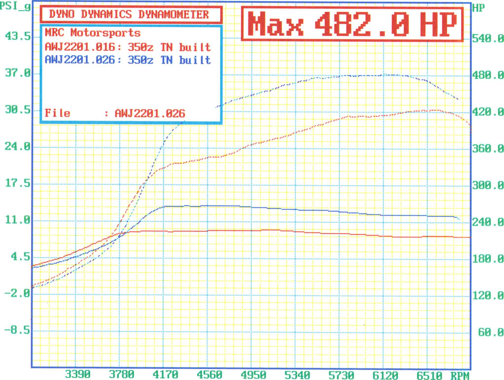

Romey, no shots taken or intended, im simply having a technical discussion in regards to Lewis's set up and tune, and the discouraging results. I appologize for any LOW BLOWS I may have taken..I will keep it on topic and scientifical from this point so that the members of the VQ community may prosper from our learnings and advance foward.
Considering all of his piping was "HACKED" up, so well hacked in fact, STS copied our piping design on their future kits..
Also can you explain as to why, with an upgraded intercooler on his car, and the sheildied piping, he should no be experiencing the high AIT he is seeing..Especially with the larger turbo running at a fraction of its efficiency..
I know how to diagnose, and with AIT's as high as they are on his car, the diagnosis upon my evaluation would be one or more of the following
A) run about 12 dgrees of timing..(which would lead to extremely high EGT's thus melting his pistons)
B) Try a methenol/Alcohol injection kit to lower AIT's
C) Remove the kit and opt for a more efficent turbo kit design..
Considering we are not running a large displacement domestic engine made from solid cast iron here, the VQ's design is very different than the current domestic applications on the market.
The current domestics your reffering to can make 30whp from installing headers and exhausts, and your comparing them to an aluminum block with 2 liters less displacement, that is prone to heat soak, hot spots, and detonation. You can throw 4 lbs of boost at most Domestic engines on a stock fuel system and make 150-250 whp without breaking a sweat
Please expound as to the boost, and WHP levels your running on your car..
Then please show me 4 BACK TO BACK dyno pulls of your system in 70 degree weather with no cool down in between. Time them with a stop watch to show a 5-10 second interval to simulate REAL WRLD DRIVING CONDITIONS.
I do Not want just the highest HP level achieved on one pull after a one hour cool down period.. Then please post the UTEC Knock count logs and AIT's as well and prove me wrong..Please...
Here is a dyno from what i thought was the most inefficient turbo kit on the market, until now..
Ill even go one step further in the name of science and the VQ Community to set this issue straight in the interest in obtaining real life factual data. Without the in fluence of marketing Hype, friendships, sponsor obligations, and general "know it all" BS being spewed forth...
I am willing to DONATE FOR FREE, my TIME, and my DYNO, to LEWIS, and do 5 back to back consecutive dyno pulls from start to finish to compare ther results.
I will DATA LOG, and VIDEO TAPE th enetire process, and post my findings on this very forums to set the record straight..
Providing STS or other members of this community, pay for Lewis's GAS AND TOLLS to my facility, so he does not have to be out of pocket doing further R&D for STS..
How does that sound???
