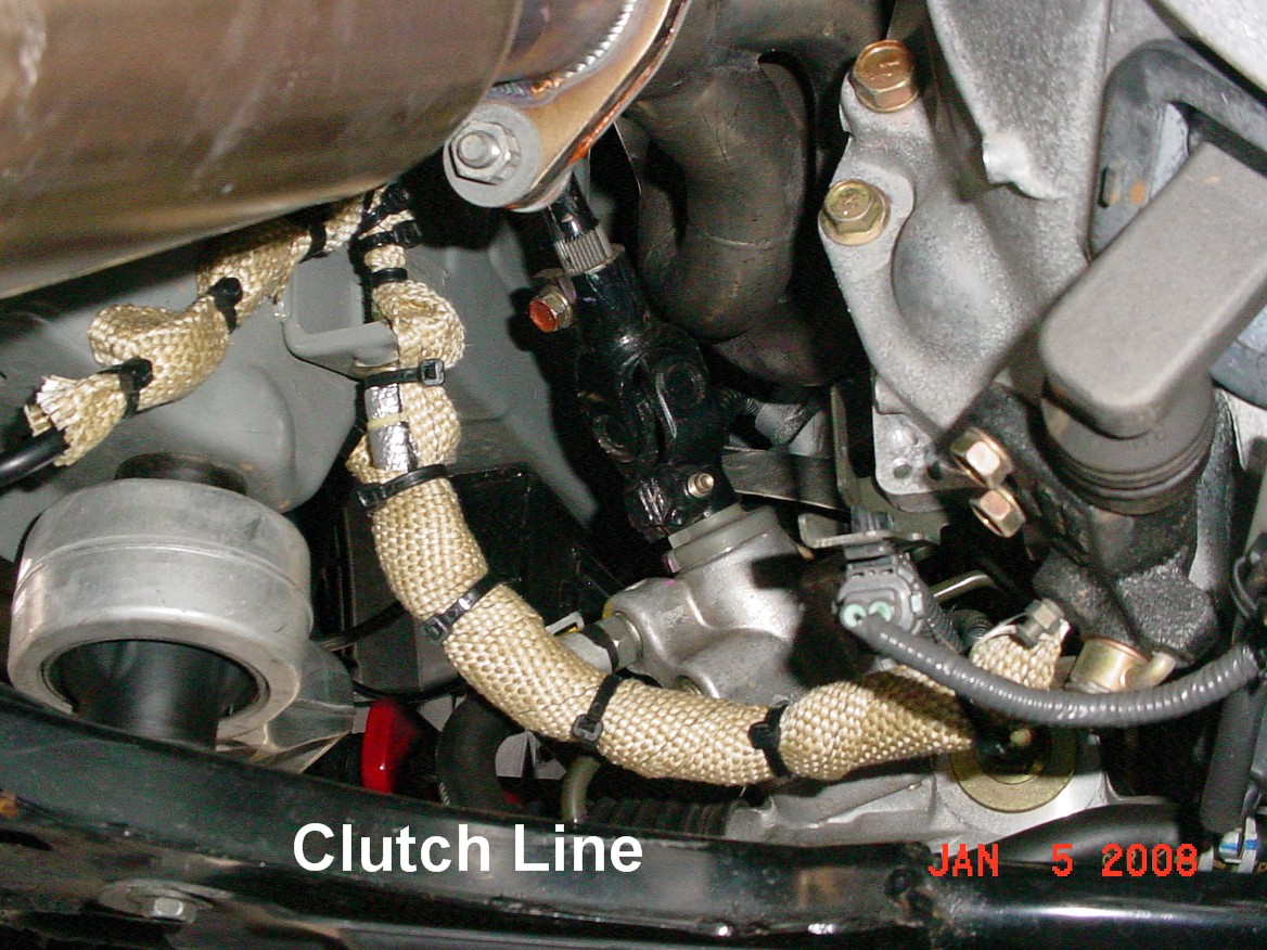

Ouch! Glad to see a happy ending. :-)
I'm only running headers and put header-wrap over the oem-wrap just to be safe.

^ If you had a TN kit there would be pipes all up in that area, lol.
I am going to be more careful how I route the line this time, and wrap it a ton. Also the better quality of the Forged line should help, it has that nice coating on it.
