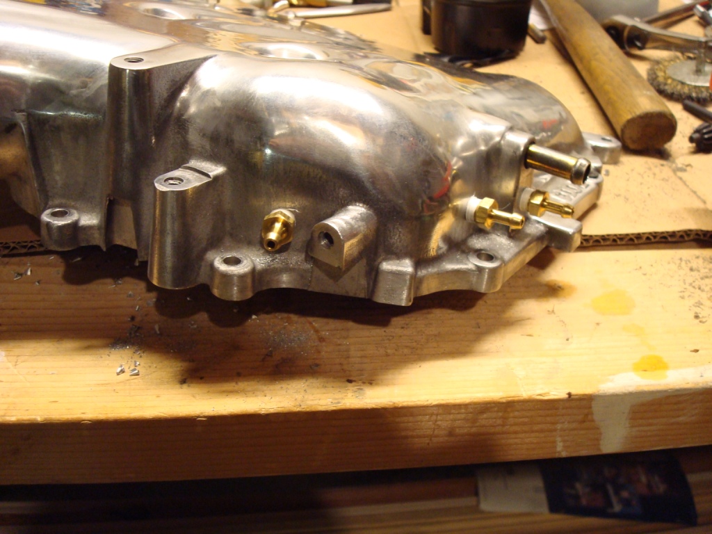

I would drill and tap for each line you run into your manifold, don't use T fittings and hook multiple lines to a single bung.

Thanks for the pic I thought under the brake booster would be good just wanted to double check. I have a appointment wed for a tune and need to get it done asap. Went turbo sold procharger

drilled a hole last night under the brake booster line thanks for all the help.
