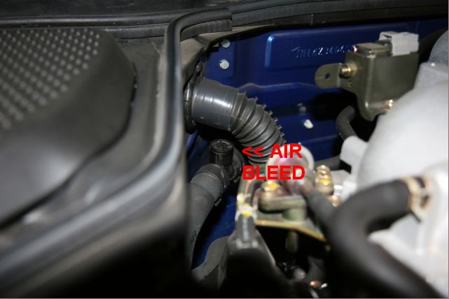

There is also a cooling system air bleed here:
Unfortunately for those of us with the APS TT's that handy little bleeder valve is no longer there....I have read so many different ways of bleeding the air and was wondering.. if the heater is blowing hot air, does that mean all the air is out of the system????
Well aware, that is the bleed valve I've always used. However, I today I found it exceedingly slow compared to sqeezing the upper radiator hose repeatedly, revving the engine repeatedly, and repeating.
Of course with this method a spill free funnel is a must.
