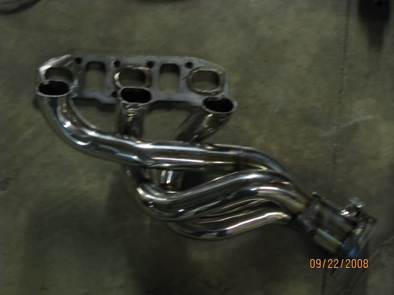

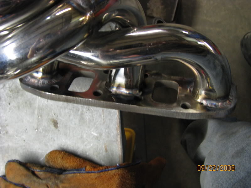

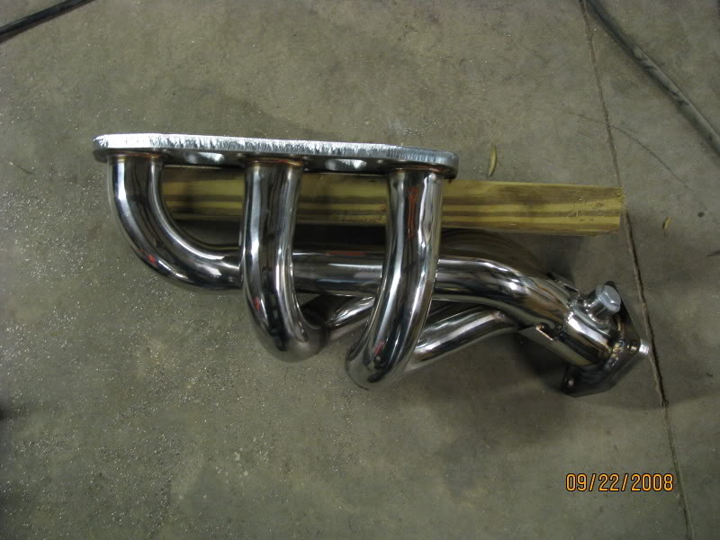

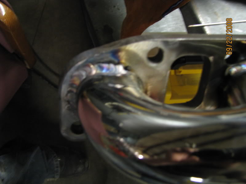

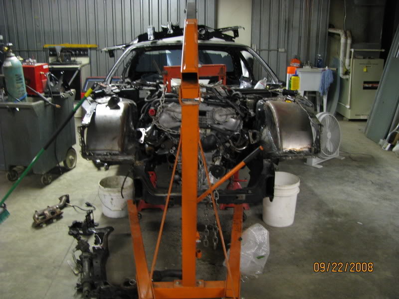

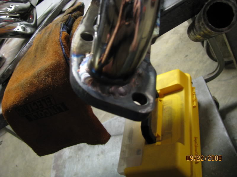

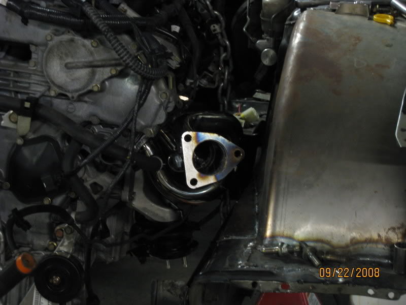

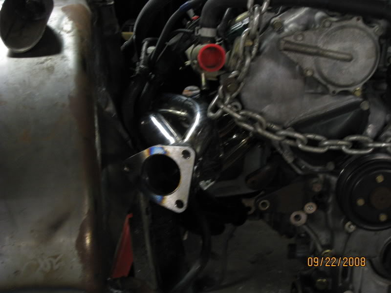

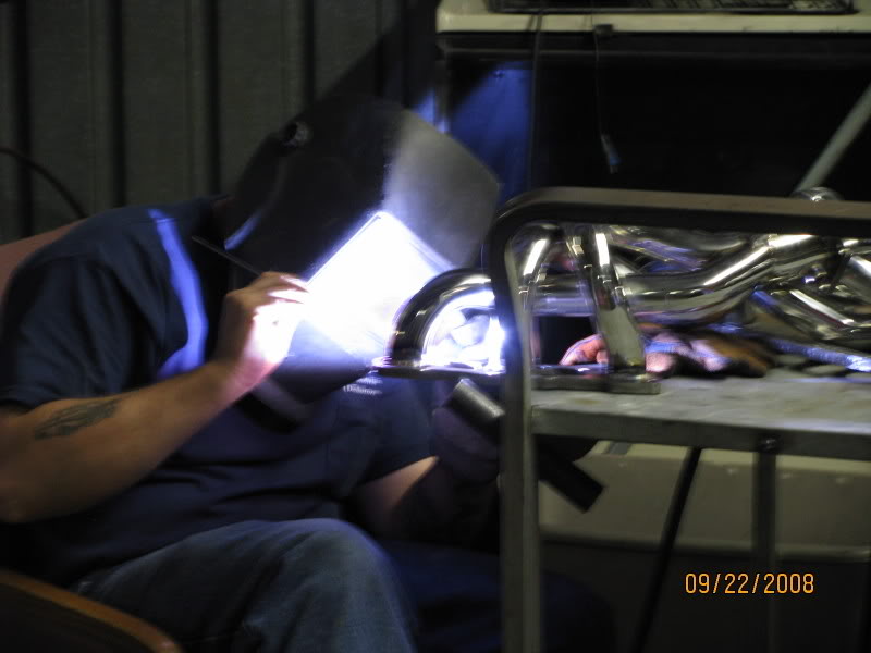

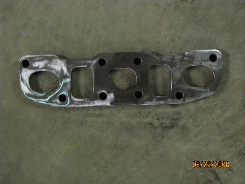

Ok on with some updates. Ameen, Mike and I are working together to come up with a design for a single turbo setup. We came to the conclusion that trying to run such a setup on the car would only be possible if we use the space in front of the motor. We played around with the stock manifolds to find different possibilities. Our first idea was to switch the manifolds, problem was they got in the way of the alternator and the AC compressor. We then tried putting the manifolds back to stock location, then turning them 180 degrees which would have worked great if it werent for the two top corner studs not lining up. So our only option was to cut, flip and tig them back together. So we bought some stainless steel headers:
Cut the flanges off:
Got out the grinder, ground down the old welds:
Let Mike do his thing, which I am still learning how to do:
Some of the welding process:
Did the other side and test fitted:
Now we have to cut the "triangle" type flanges off and put on v-band flanges and start work on a cross pipe to join the two headers the the turbo. Thats all for now.
