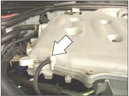

3) Is this the where I need to hook up the mainfold vacumm hose for the SS box (see pic)? If not, where should I hook it up, and can I tee off the same line for my boost gauge?
Attached Thumbnails Gauge/Vortech questions-vacumm.jpg

3. yes you can hook it up right there and T off for the boost gauge.
