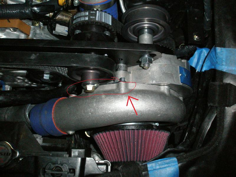

Do you have a close up pic of the bloer and jackshaft assembly for the rrev up ? My first thought when I read you wanted to go to the 8 rib like Quamen did , was .....is there going to be enough room for the wider serp pulley on the jackshaft . Maybe the Rev -Up is different , but on the older kits , I dont think there would be enough room . Im going to search around to see if I can find a pic of what Im talking about .
Here is the area I was thinking of . And it looks to have plenty of room for a wider pulley....never mind...lol

Booger it is good to see you are staying around!!! i have measured the area you are talking about and yes a 8 rib will fit on the rev-up applaication. there will not be much extra clearance though.. 1/16 of a inch is all that will be left between the serp pully and the volute retainer plate. i may be able the shim the blower out some for some extra clearance but in turn i will have to adjust for on the cog idler pulley at the same time.

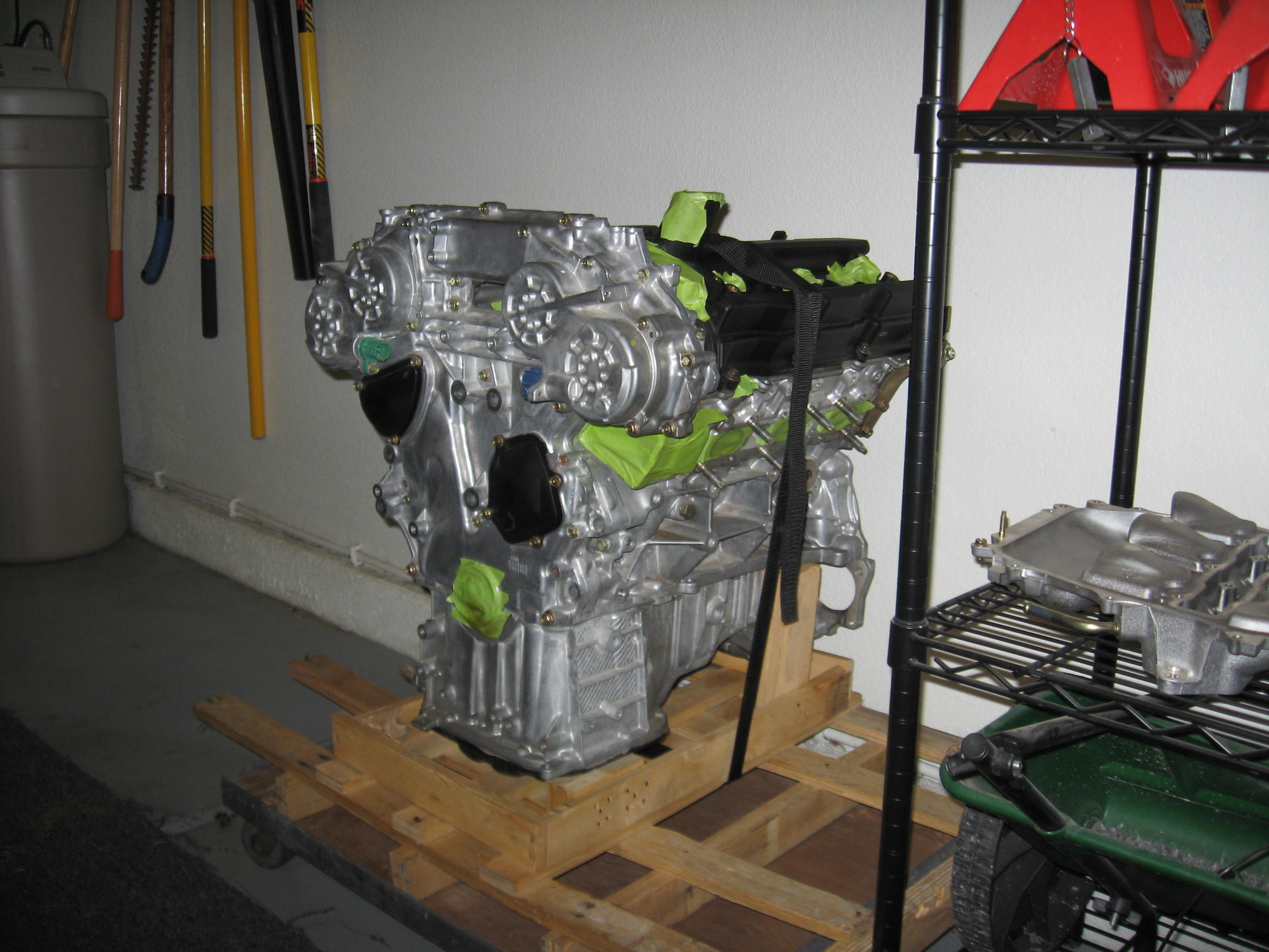

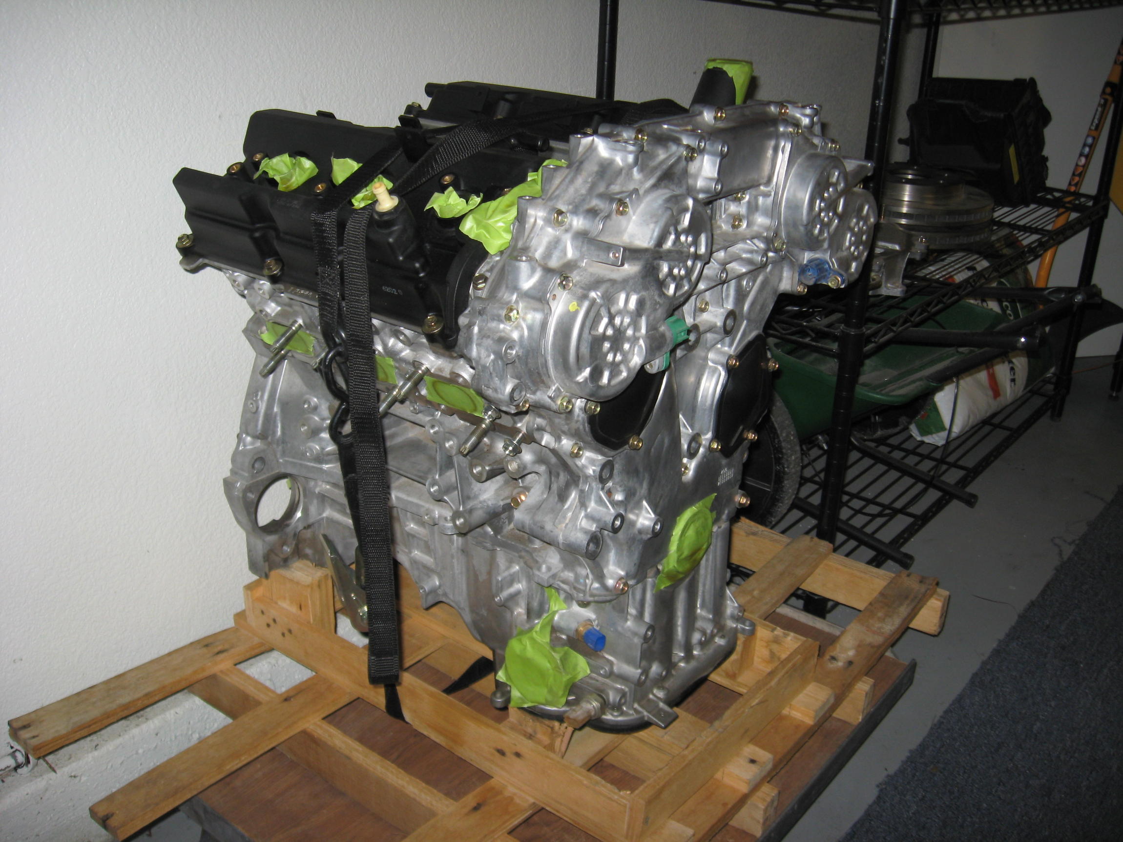

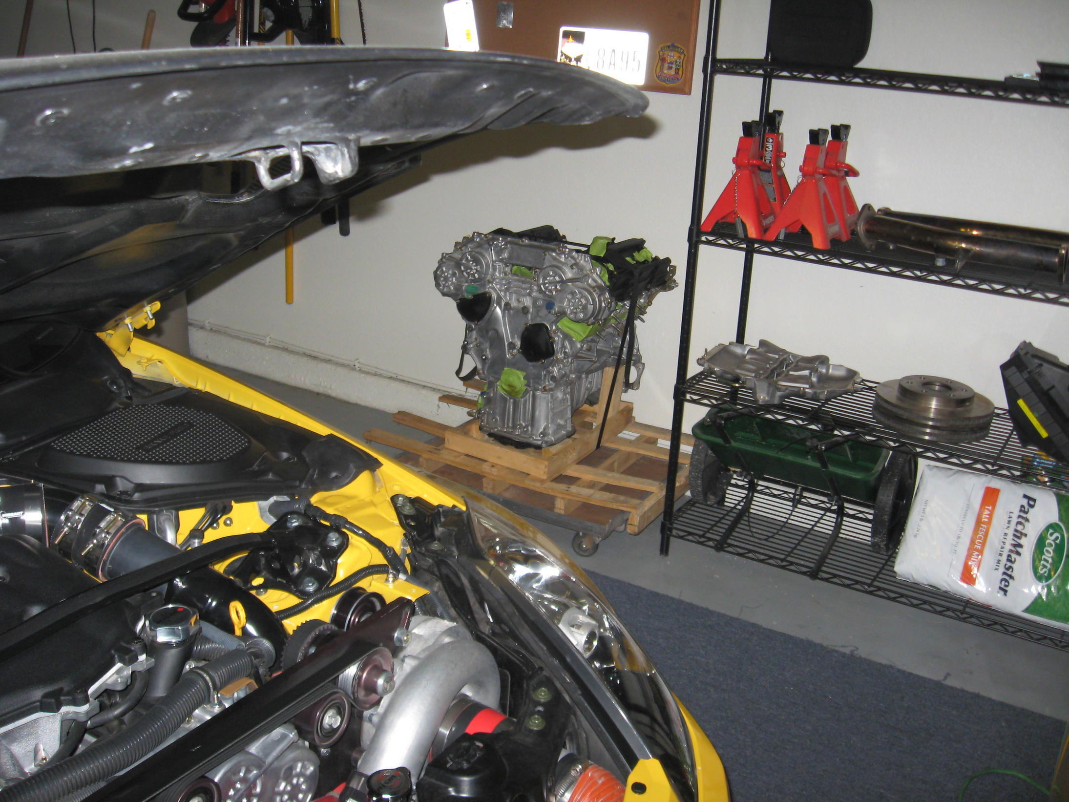

made the first step for my build project. here is the spare 06 rev-up engine that i will be building .i picked up for a steal "$350.00" from a local nissan tech " thanks to Stan " it has 22000 miles on it and was pulled for the oil consuption bulliten. i know the previous owner of the engine due to he is part of the vegas z club out here. the nissan tech i purchased the engine from let me know that this engine BARLEY met the criteria for this engine to be replaced under warranty and that he had to fuge the figures a bit for the owner to get a new engine in his z. regardless it does not matter due to the pistons and rod's among many other assemblys will be upgraded. over the next couple of weeks i will be doing the teardown and inspection as well as start my laundry list. will keep you posted.
