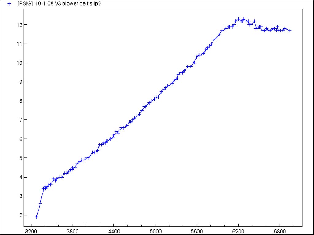

ya this is belt slip due to not tight enough idler pulley. couple turns of the 12mm and all linear.

hmm. Does "linear" in this instance mean "smooth", or maintaining boost up to redline (i.e., in the posted graph, is the noticeable belt slip throughout the rpm range, or only on top)?
I found some residue on my bracket and around the SC pulley, but this may be due to running an alternator belt that was too big and was squeeling. Now I have the proper size belt and everything is nice and tight. I don't hear any squeeling or abnormal noises and everything sounds nice up to redline.
My boost looks linear and peaks at 12 psi at ~5500 rpms. After that, boost begins to drop to ~9 psi by redline. But this decrease seems "linear" as well, there aren't any spikes in the psi reading. So I don't think any of my belts are slipping, but is just the nature of the SC I am running?

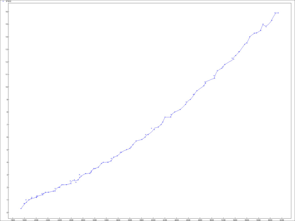

On a centrifugal blower, it should rise all the way to redline. Attached is the graph of the same setup as the log above, but with a tight belt.
You car makes 'turbo' torque #'s so maybe its supposed to have a turbo boost curve. Dont know enough about rotrex blowers.
