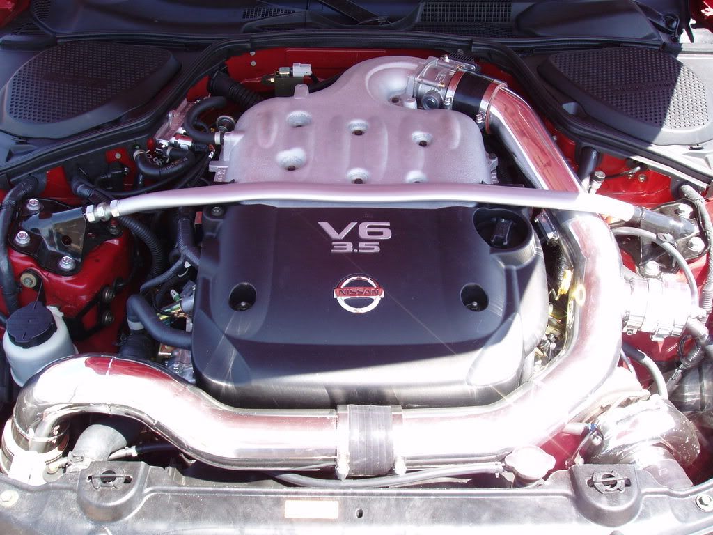

Another question is can you still use a front strut bar with the PL kit as all he pics I've seen don't have a brace on?
Are you referring to the crash bar, or the strut tower bar?
The crash bar can be re-used, but just requires you to notch it to clear the I/C.

I was meaning the tower bar but thanks for the info on notching out the crash bar on the front. Does any one have any pics from under the car with the PL kit on as all the pics I've found are just engine bay shorts or the PL kit pics off there own website?

The PowerLab kit wouldn't effect the tower brace....

I just put my strut tower bar back on with no clearance issues. I do have a few washers placed into mine to raise it up alil since I have a plenum spacer.

Strut bar fitment is fine.I didnt space anything out..but forget lowering your car if you have a PL kit. My car is stock ride height and I hit on every speed bump.
