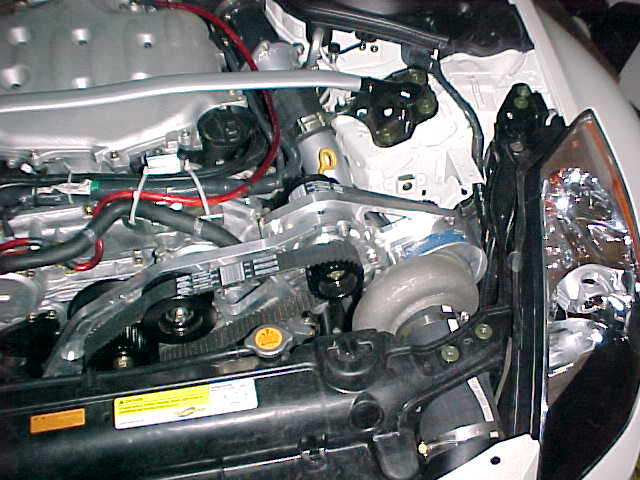

Oh, and here's a final pic of my install. Just for those curious as to what it looks like on a PPW.

jesse: Is that the Non-polished blower? It doen't look shiney like mine does.

Yeah, I got the non polished one.
