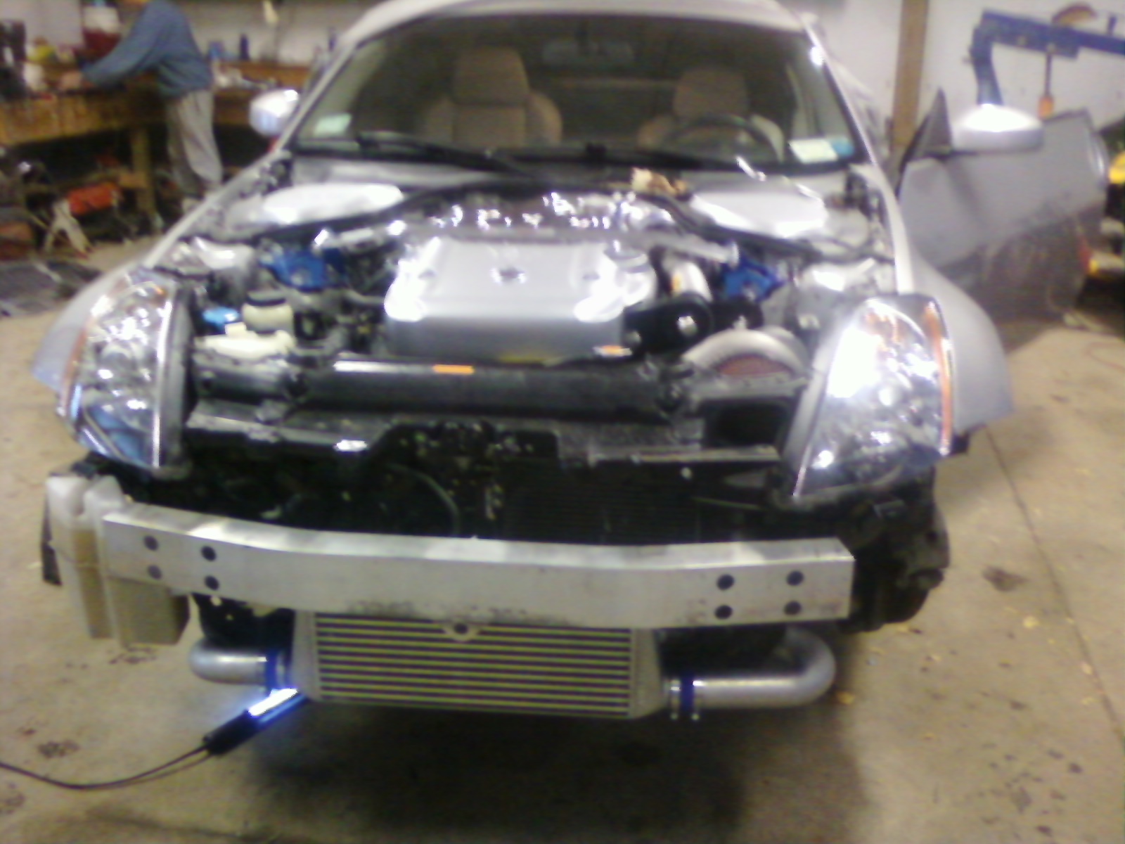

heres a pic, see how the left is angled just a little under on the side where the light is...it made for a little more cutting when putting splash pan on, but can't tell now and made a great fit, just somethin to consider

Originally Posted by tylerxfire
heres a pic, see how the left is angled just a little over on the side where the light is...it made for a little more cutting when putting splash pan on, but can't tell now and made a great fit, just somethin to consider
humm i might try that next week on my day off. Thanks for picture tyler.
