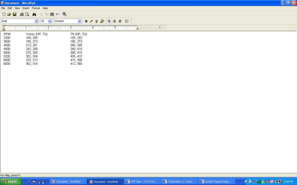

Originally Posted by Chef-J
Changed, much better competition Same dyno.
That's mine, mods follow here https://my350z.com/forum/shop-builds...non-revup.html
Here's a chart I just fixed up using those two graphs. Like I saw in the other two, they're neck and neck until around 4k were the TN takes over.

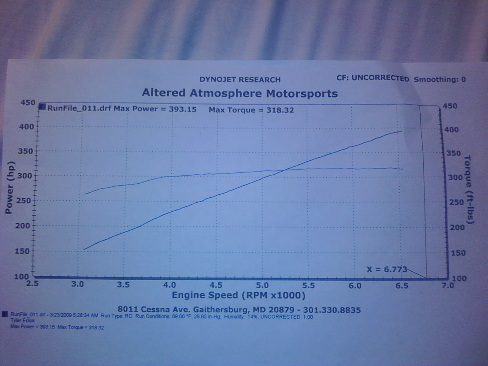

another to compare

turbo's got the torque hands down, but is it usable on the street? cause i know my 300ft. lbs. at 4000 rpm is useless in the lower gears...vortech seams to be great at mid and top end power and pretty safe, once the pulleys start dropping seems to give soem good power and with the 2.87 torque is higher and starts hard at like 3700 rpm

different dyno's different numbers...cant go by that
In the chart I typed up they're both from the dyno at Injected.

IMO that looks like a pretty strong TN car vs a 3.12 pulley vortech that are on the same dynodynamics dyno there.
I have a ton of dynos I can pull out that I've kept over the years organized by specific shops. From what I've seen, the TN starts losing steam up high, and the vortech can catch up to it
IMO the results in first gear will be almost negligible between the two since you go through 1st so fast, you hardly have time for the TN to spool up early.
Look at the drag racing times in the drag race forum....the vortech and TN can be fairly well matched in the hands of a good driver.
