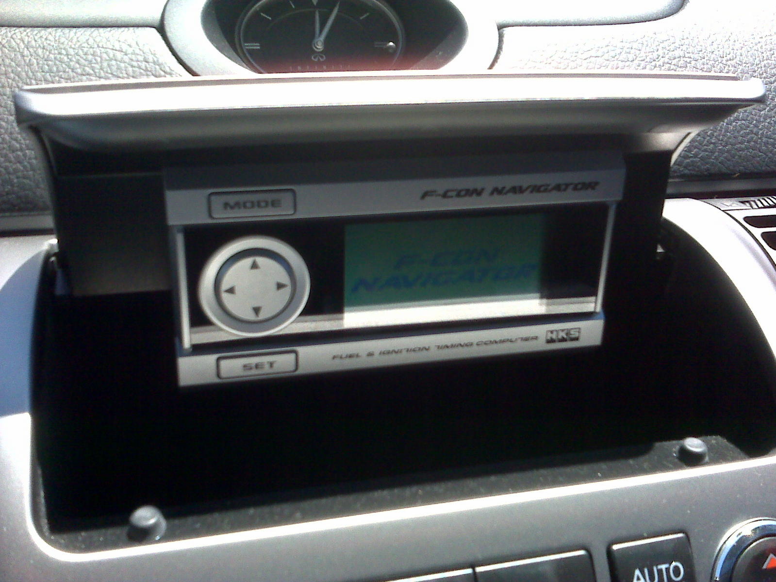

I have an Fcon Vpro with Navigator.
The Navigator is only showing the words "F-CON Navigator" after its normal power up sequence. Usually after powering up it displays a status screen with a table of assorted sensor readings like rpm, IAT, temp, etc...
Car seems to run fine. See attached pic.
Anyone have this problem before ?

hmm never seen that. Have you tried unplugging it from the Fcon and replugging it back in and see?

Thanks for the reply. Yep, just tried unplugging it and plugging it back in - no luck.
Its weird, When you turn on the key it goes through the start-up procedure and scrolls HKS and then just displays "F-Con Navigator" and thats it. Pushing Mode or Set does nothing.

What version is your F-CON V Pro. The newest one is vers. 3.3, but the Navigator Pro will not work with it. The Navigator Pro does work with vers. 3.24, and maybe some earlier versions.

Toast, I will contact HKS tomorrow and let you know what they say. It sounds like a bug or corruption of some kind. Never seen it before...ever. I figured XKR would be the first to break his..not you.
