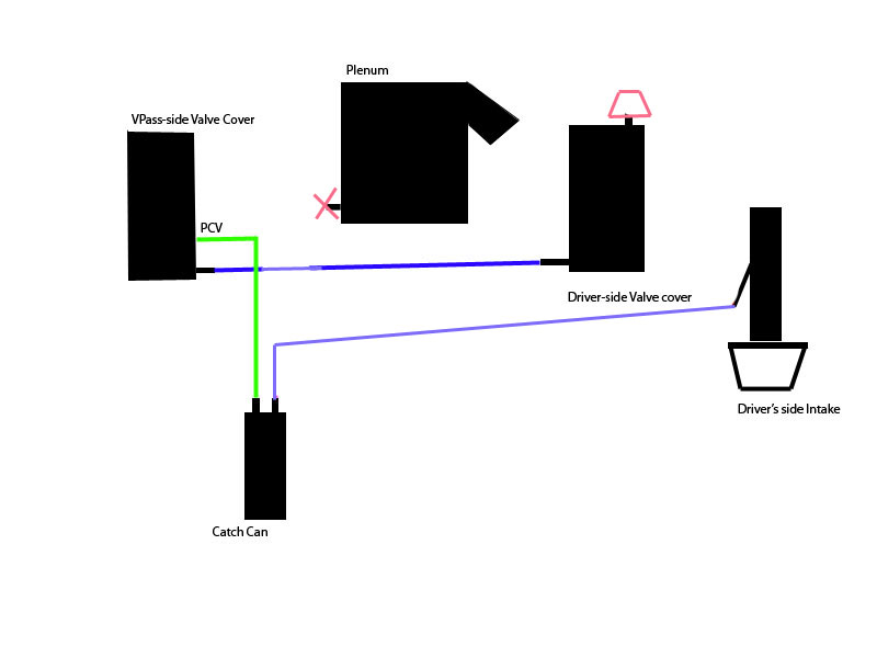

So, is this what everyone is suggesting?
What about all the one-way valve and stuff that you guys were talking about before? Forget all those and just go with this simple setup?
Wouldn't that little filter in the back of the driver's side valve cover spill oil?

Well technically if the compressor side suction is strong enough during boost, air should be going IN the driver's side breather filter pictured above. That said, if blow by is high enough, then the filter also allows escape of the extra gases, preventing crankcase pressure build up. That breather filter may get soaked with oil. If that happens, you can use a 2nd catch can rather than just the open breather.
You don't need a one way check valve IF you seal off the plenum and IF you don't have a recirculating valve (versus a BOV to atmosphere) on the driver's side piping (I do so I need to make sure that surge of air does not find it's way back into my crankcase).
Soooo~ Do you approve of my drawing or am I still missing something? Yes or No please~!
Yes, looks good. lol.
I was only being verbose in case you noticed oil dripping from the breather. No way to predict if that will happen. I would try what you have pictured.
