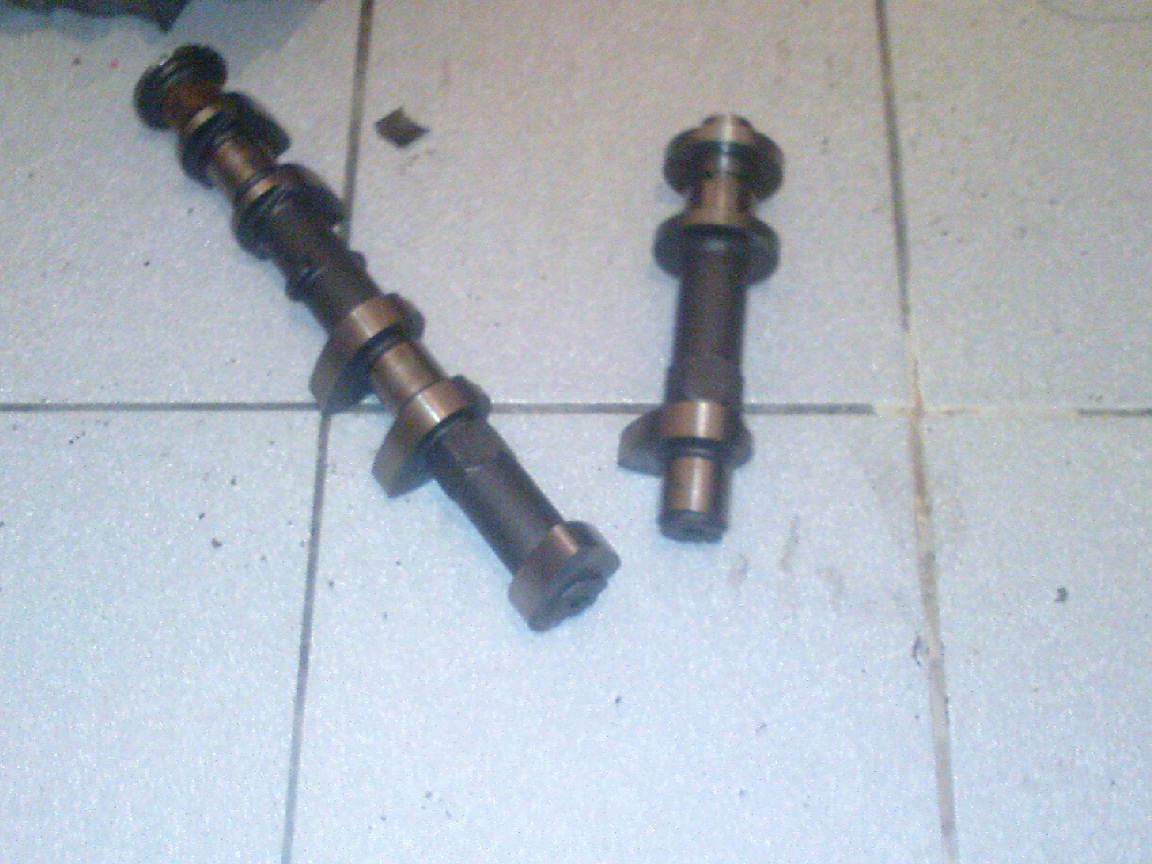

Default this is not the end of the story
i just inspect my heads to make sure and look what i found wehehehehehe
ugly !!
ugly !!
What the hell is going on here??
i dunno man its really funny, i built allot of VQ engines here in kuwait with 0 issues, this short block i orderd form what ever and look what **** im in to
Old Aug 4, 2009 | 07:11 PM
failsafe306's Avatar
failsafe306
iTrader: (38)
Joined: Mar 2005
Posts: 7,040
From: OK
what does it take to snap a camshaft like that?
Old Aug 4, 2009 | 07:45 PM
thom000001's Avatar
thom000001
Joined: Oct 2007
Posts: 1,891
From: Chicago
I told ya something was up with the cam timing.......of course the final result is a little more excessive than I expected lol.
tom
Old Aug 4, 2009 | 08:01 PM
SmallTuner's Avatar
SmallTuner
Joined: Jun 2008
Posts: 894
From: kuwait
tom
lol ur right, its realy funny how things happend this way
u shoud have look in to my face when i removed the cam and a piece of it just fall down lol
just like a salted Pretzel stick
