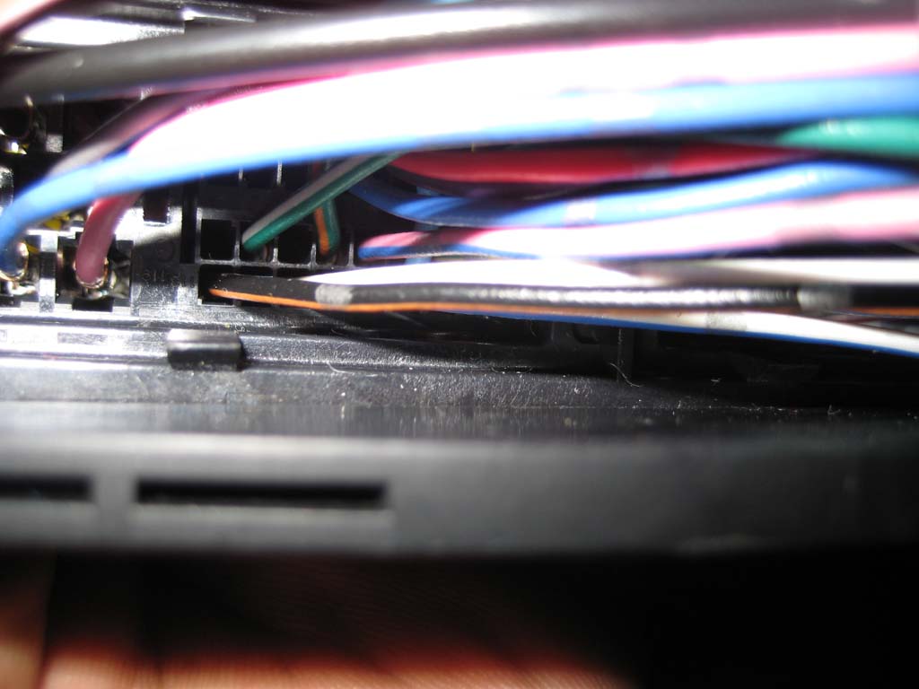

so On my 2003 G35 you can see pin 101 is the pink/blue stripe line. Remember that in the FSM, you are looking at the side the wires come in, not the female pin side.
Pin 101 is the P/L 5th pin from the left on the 2nd row.
But, people keep saying they tap into their haltech harness to add in a switch. But how are you doing that. My harness is encased in a plastic shell and this no pin wiring diagram for the red box with its 3 harnesses.
So whats the secret? Which wire is Pin 101 on the haltech side? Obviously I'd rather not touch the stock harness if at all possible.

I did mine in the stock harness because I didn't have the haltech at the time. However, I don't believe pin 101 goes into the haltech, just through the patch harness. So trace it from the stock ecu connector to the patch harness and splice there. It works perfectly. Like others have said, if left undone it keeps cruise control from working (takes a week or so of driving for me o have this effect) but in this case all you have to do is close the switch while driving then come to a complete stop.

duh, makes sense now, I forgot that the stock ECU was buried on the floor board under all that mess.
Will have to check that end of haltech harness and see if the wires are accessible.
