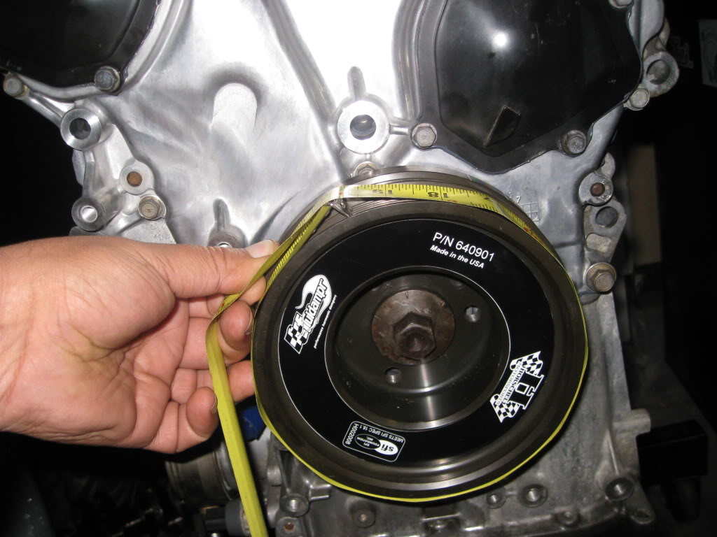

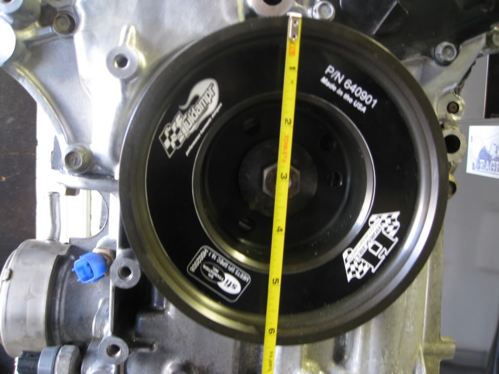

I tried taking it as close as possible
I also did across the face and it came out to 6.25"

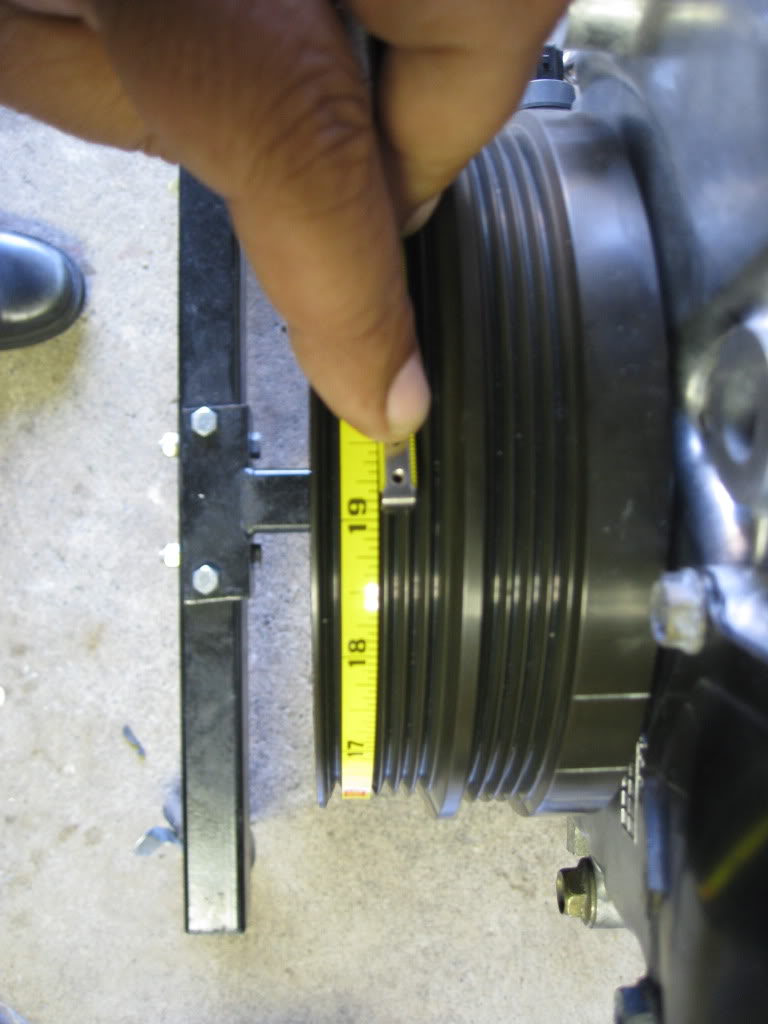

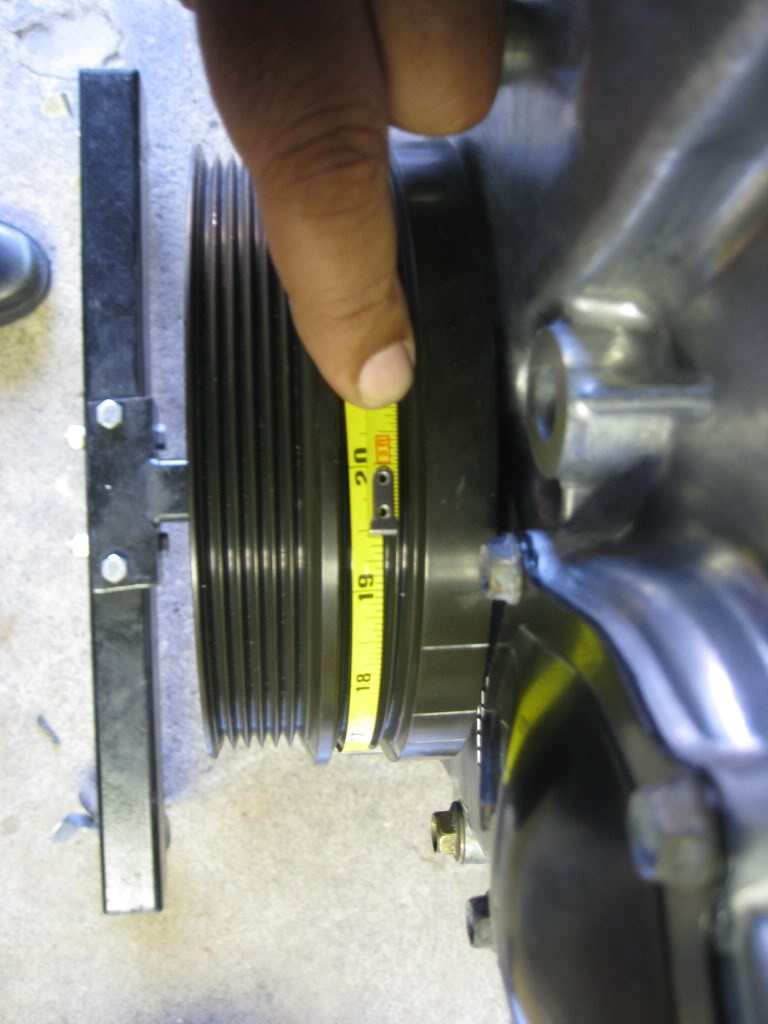

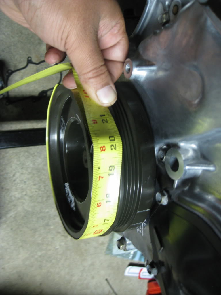

Took some more pictures with a skinnier measuring tape

I posted up pictures of the Fluidampr pulley with measurements.
Can anyone else post pictures with measurements of the oem and Ati Damper?

Thx for taking the time to post up measurements on your Fluidampr.
I spoke with ATI and Fluidamper on the actual OD, measured from where the belt sits and they are as follows:
ATI: 6.610"
Fluidampr: 6.125"
Everyone says the stock is 5.745", but I haven't actually measured myself.
If I had originally bought the Fluidampr, instead of the ATI, I might have left it on, and not rev'd past 6500. However, the ATI is just too big for my application...

Fluidampr VS OEM
It appears that the pullery that runs the AC is the same diamaeter but the pulley that runs the PS and AL will be overdriven due to the larger pulley diameter.
Also the overall height of the FD is about 2mm over stock ie: it will sit 2mm further away from the enigine.
One other point of concern is the timing markers which do not appear to be the same as OEM. Can anyone comment on this?
Summary:
OEM 165mm and 150mm
FD 165mm and 158mm
NOTE: this is not measured to the top of the teeth so give or take 2mm from edge to teeth. There is a bit of paralax error in the photos
