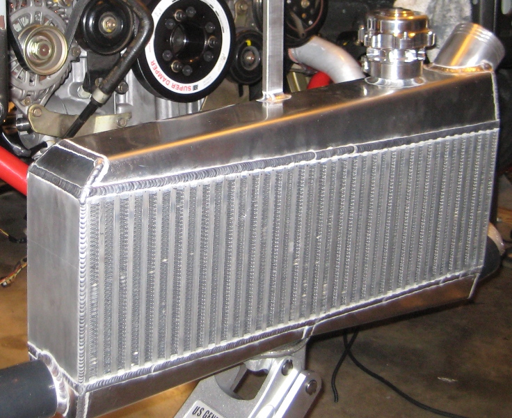

unless you had 2 huge turbos, i'd tell you installer to just use 1 BOV mounted on the intercooler.
you dont win races by dumping boost.
