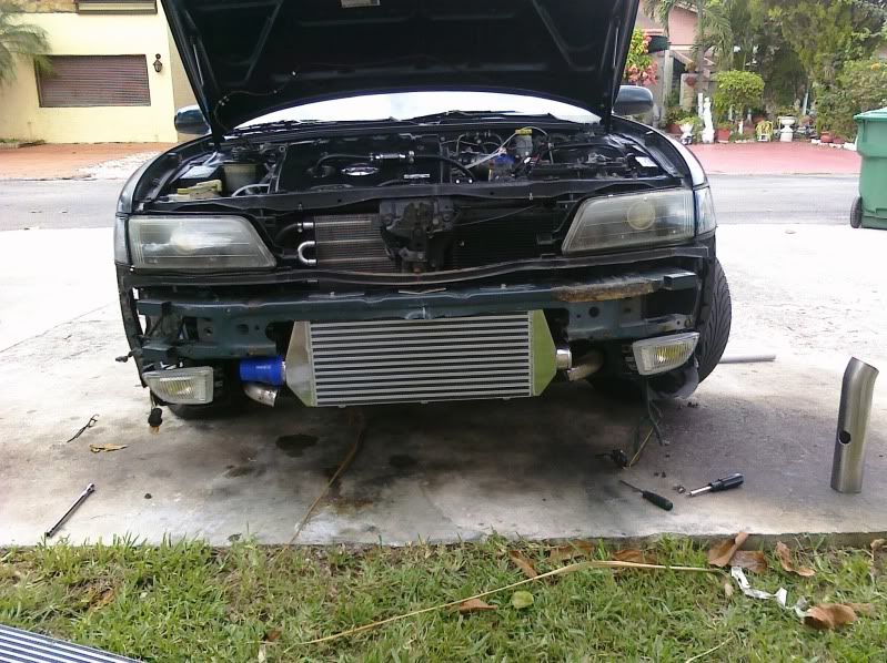

Well rather not get flamed as usual when posting out of the ordinary stuff(some peeps cant think outside the box lol), but its a rear mounted turbo setup and its on a 97 Maxima. still want the pics? lol

lol, here we go then:

Its not a clean job as you can see there are zip ties supporting some part of the charge pipe, but I did this all in my front yard with basic tools, minimal funds, no welder, no pipe bending machine, nothing lol. just heater hoses that had the needed bends, and 30 bucks worth of piping from local muffler shop. Only needed welding on the turbo to mount it to the catback (where muffler used to be).
Eventually i'll upgrade the piping for some mandrel bent aluminum pipes (lighter weight too vs. the damn steel ****). But so far, its been successful in the 3-4 years I have had it, the first rear mount turbo maxima, ever! lol
Ypipe and catback is all wrapped, so it spools almost as if it was a front mount, actually my original turbo was given to me by another turbo maxima owner which had traditional front mount setup, and the turbo on my setup spooled basically as early as it did on his, so that shut up a good amount of people yapping away about how RMT will have huge lag and bla bla bla lol.

Thats pretty sick for a DIY yard job. Arent you worried about that filter being exposed? Why not encase it?
Ever run it at the track?

Thanx man, its been a cool neverending project lol, there is always something to improve on it, and I see it as a major accomplishment, considering its the first and only car I have ever owned (since I started college in 2001), from not even knowing cars needed oil changes(i was that ignorant) to building my own engine and turbo kit, as well as tuning it myself, no mechanic or tuner has ever touched my car lol.
Well K&N sells these covers that you put on them to further protect from road debris n stuff, but I have not yet to do so, and I am worried about the restriction it would provide. In the 3 years of daily driving everywhere in Miami, through hard rain, over sand, dirt, everything, never an issue. So far oil analysis dont show any contamination from bad filtering either, but eventually i'll improve that.
well only took it to the 1/4 when I first put the turbo on, that was on the stock VQ30 motor, but wasnt very impressive at high 13's with 105 traps, was making about 280hp back then. 60' always kills me since I dont have a high stall converter. I did do more 1/8 runs though at 312whp still with the 3.0, and that got me 8.6 @ 82 on average, with 2.0 60'
