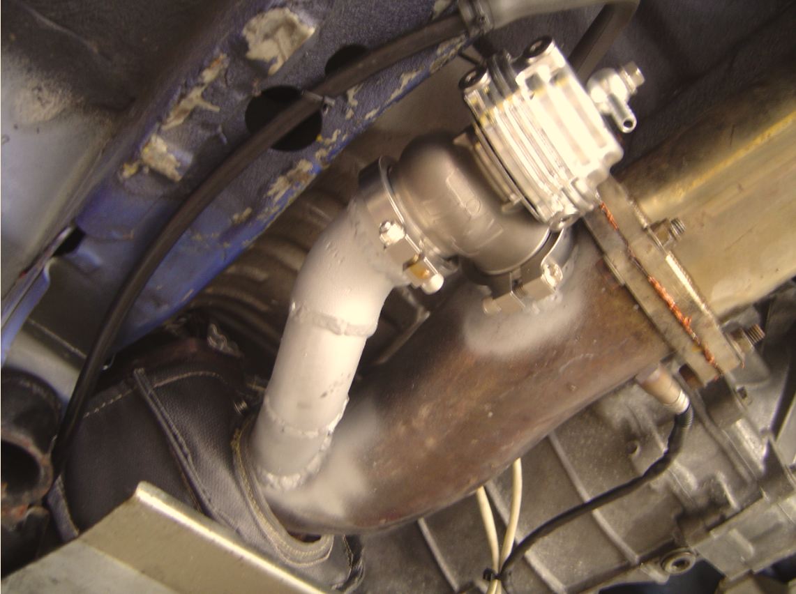

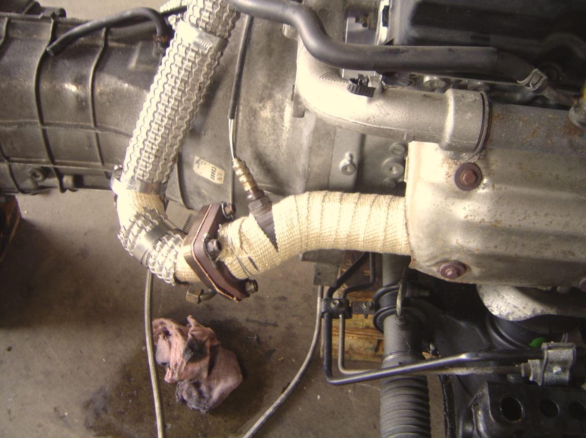

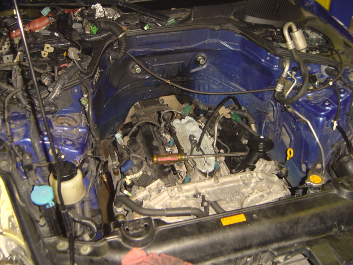

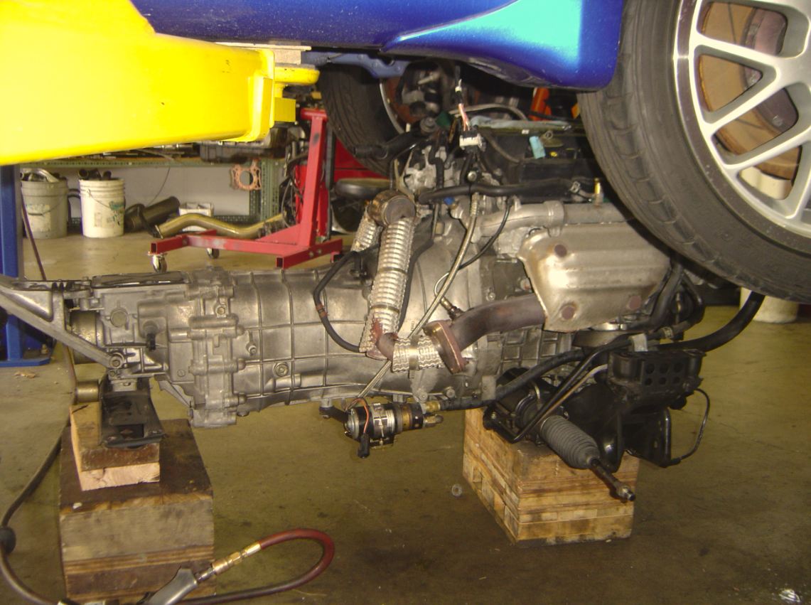

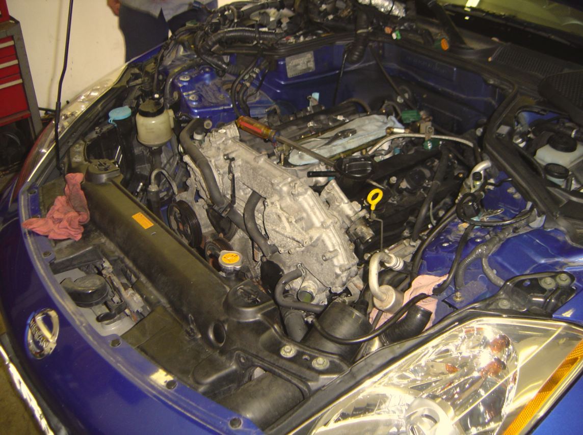

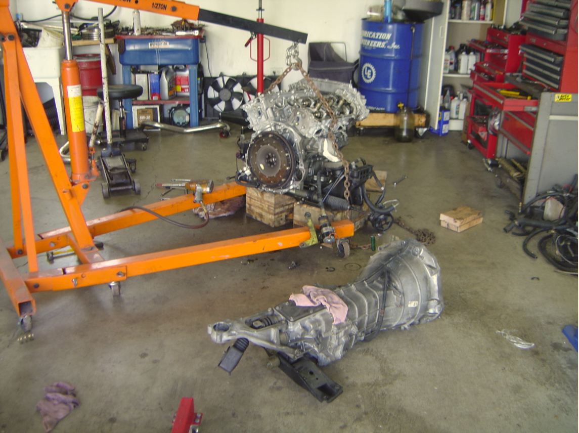

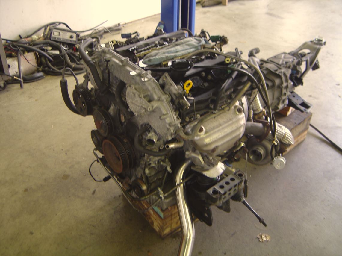

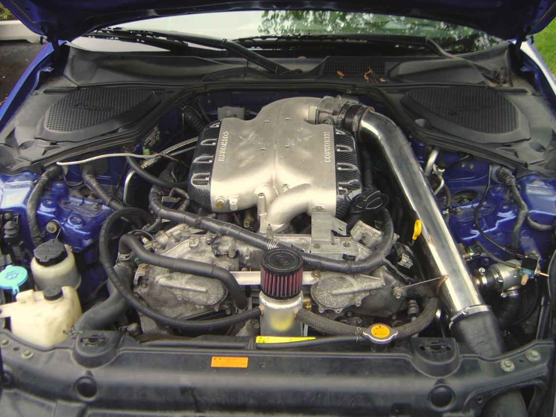

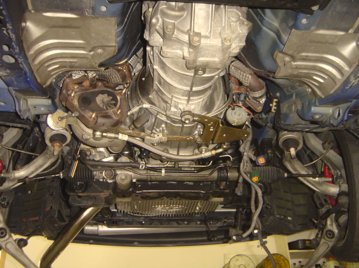

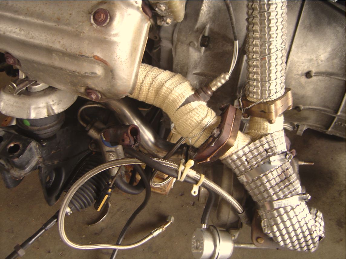

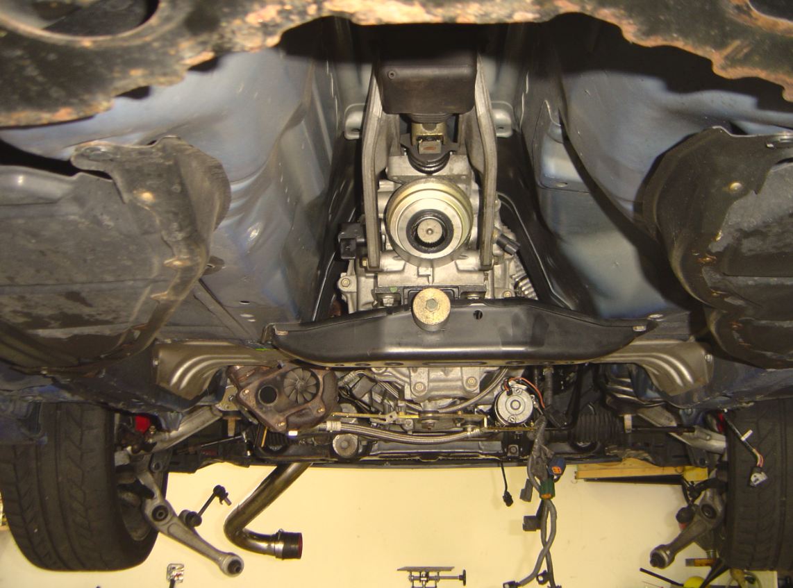

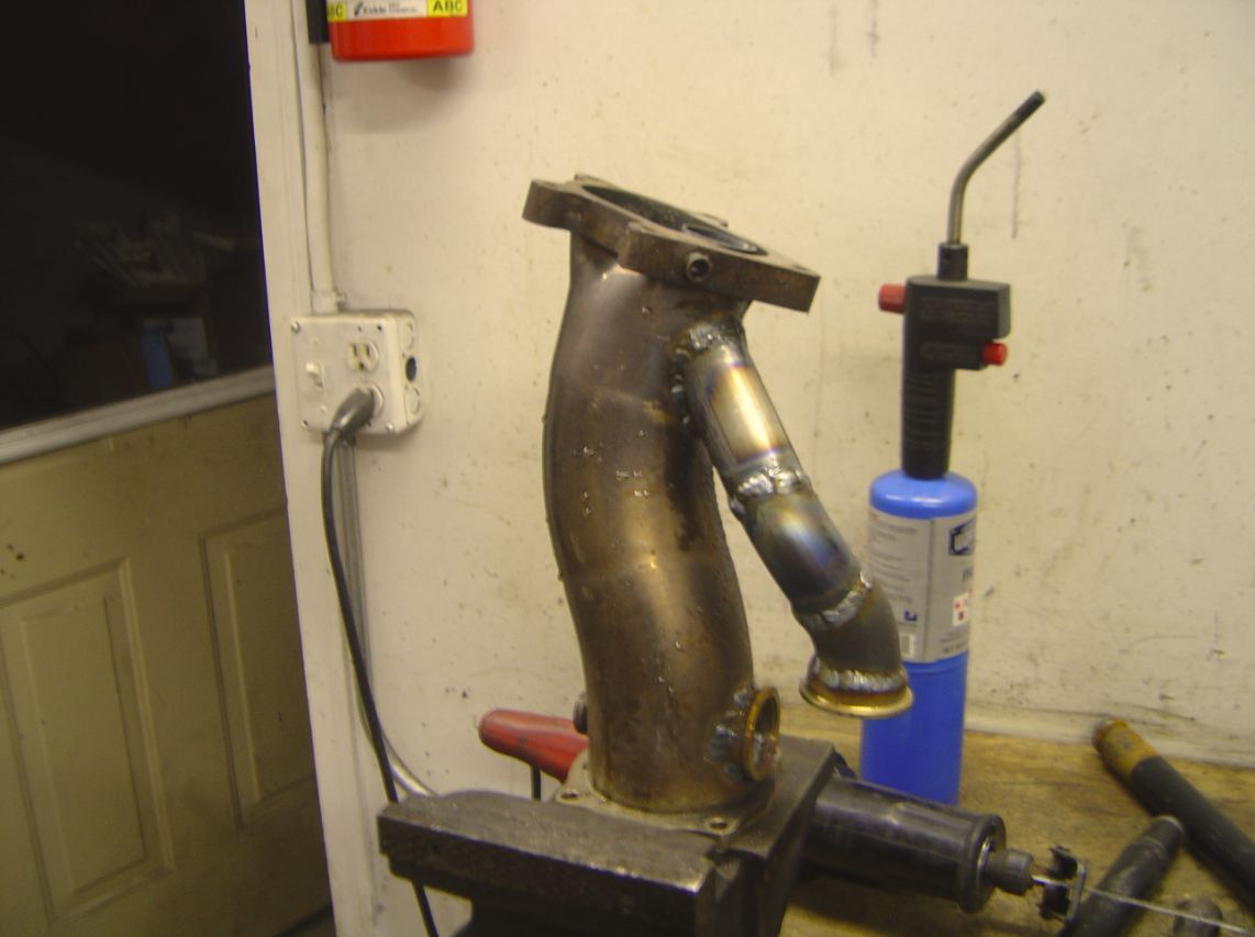

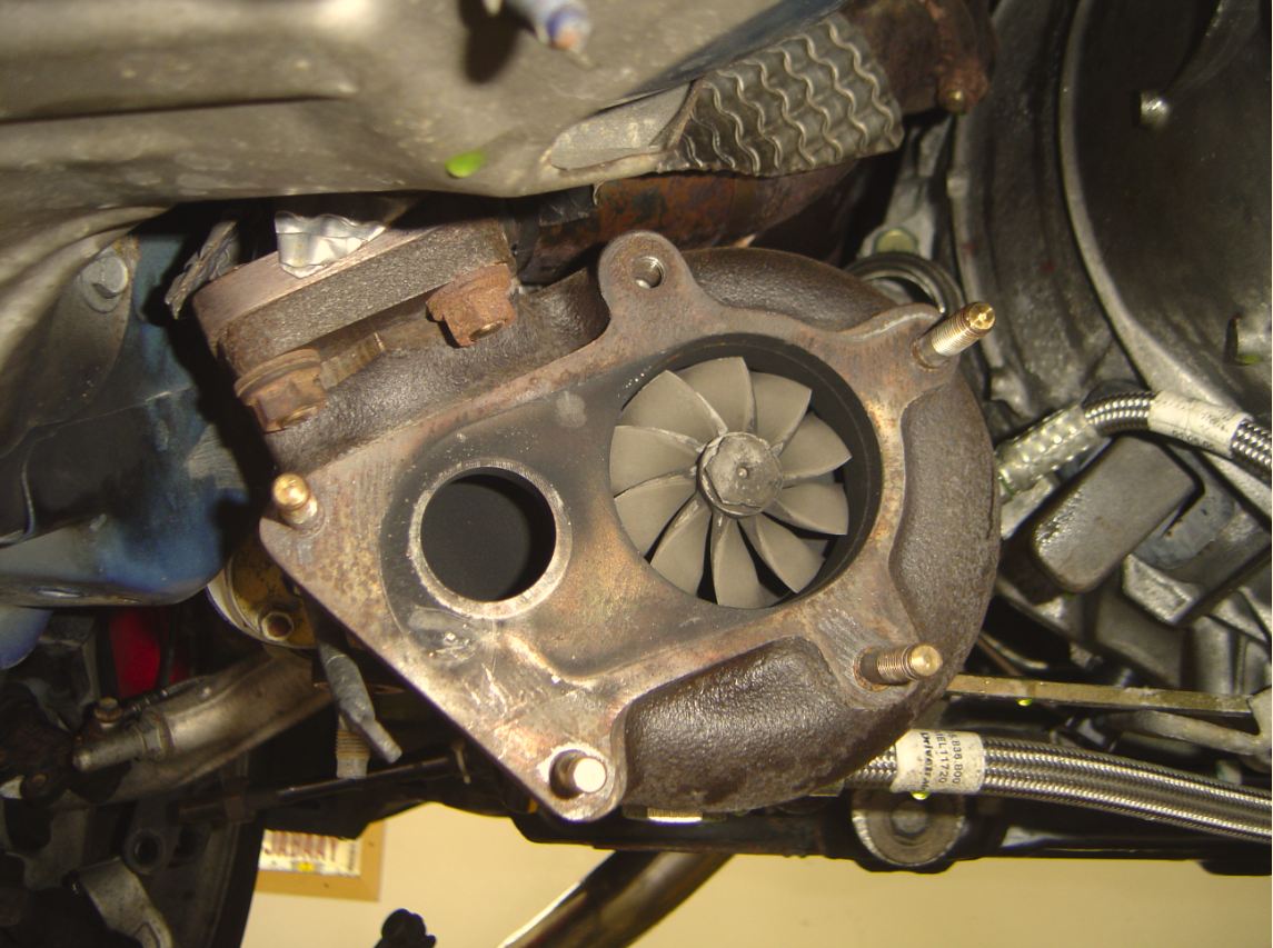

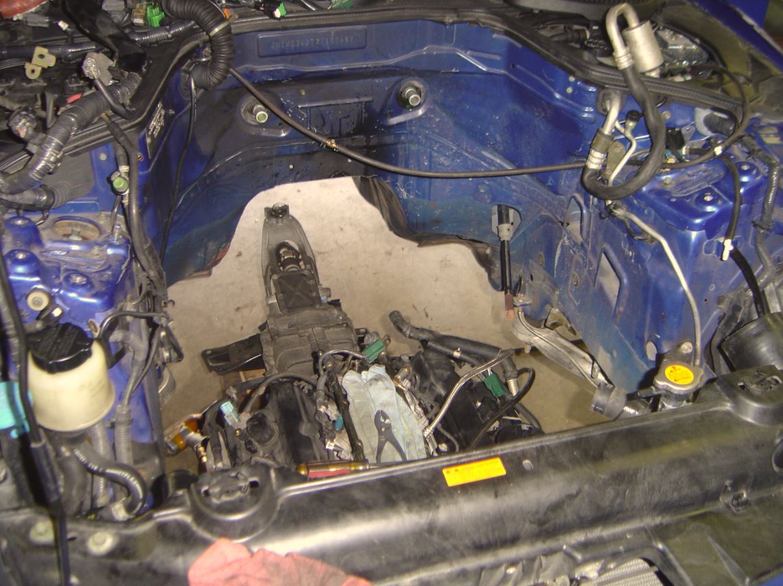

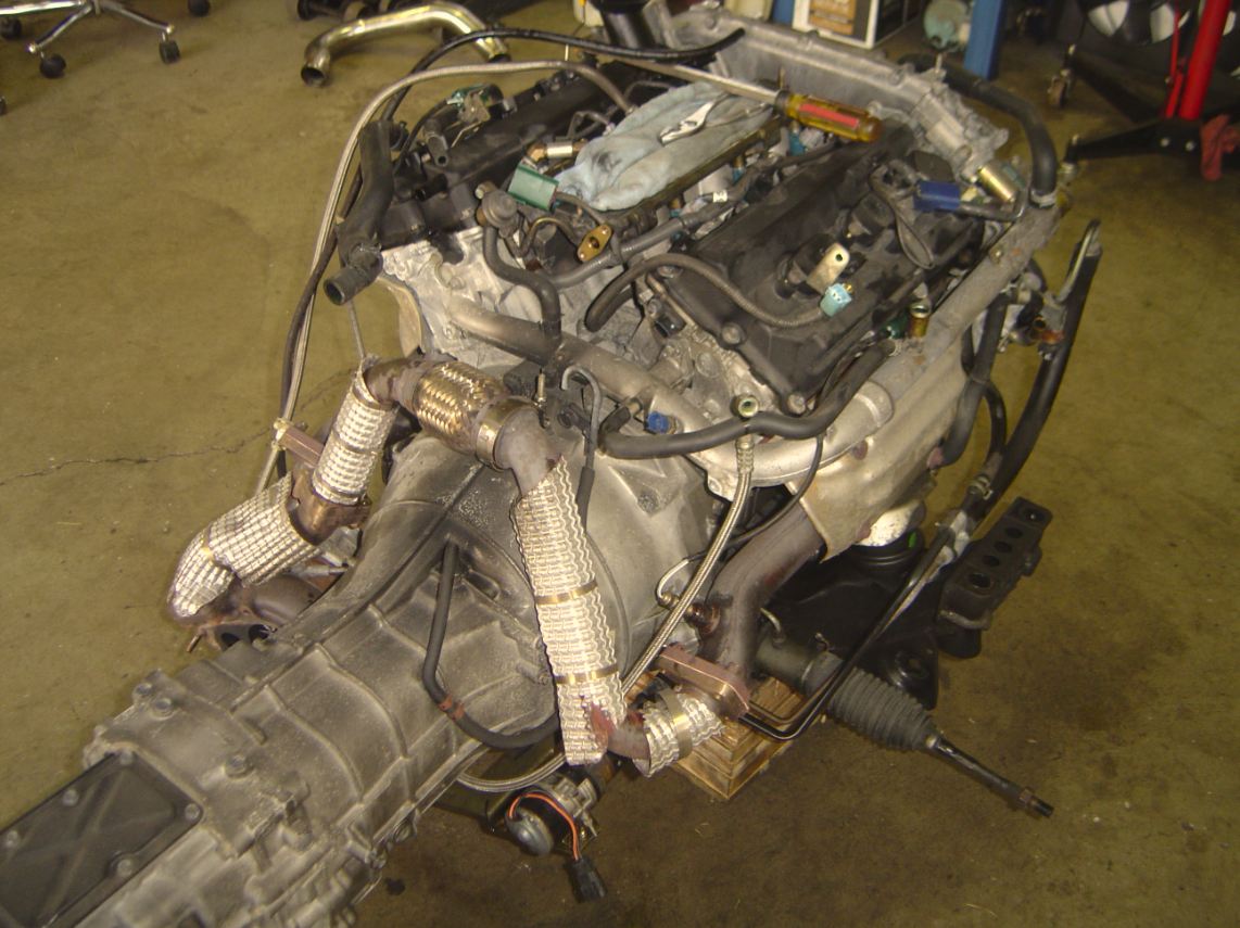

Quick background, in 2007 in got an APS single turbo installed on my stock block...made about 400whp at 10psi. Over the past few years I've purchased some extras, Stoptech BBK up front, Haltech, Cosworth manifold, 830cc Deatchwerk injectors...and most recently (couple months ago) the stage 1 long block from IPP. My friend finally got some free time to pull my old motor and install the new one. He put a turbo blanket on from PTP, header wrapped the crap out of all the exhaust piping pre-turbo, made a brace for my oil solenoid, replaced the fuel line in the engine bay to get rid of some of the unnecessary bends/fittings, custom catch can that vents both valve covers, and a custom external wastegate with a tial 38mm slime line gate. I drove the car home today with my old injectors/unichip for the break in, and have a tune scheduled at AMS in about 9 days. I'm sure there are some things I'm forgetting...but that's pretty much the meat of it.
Once car is tuned, Ill post numbers/graphs with results. Cross your fingers...I'm hoping to be pleaseantly surprised, but likely it'll be around 500whp.
