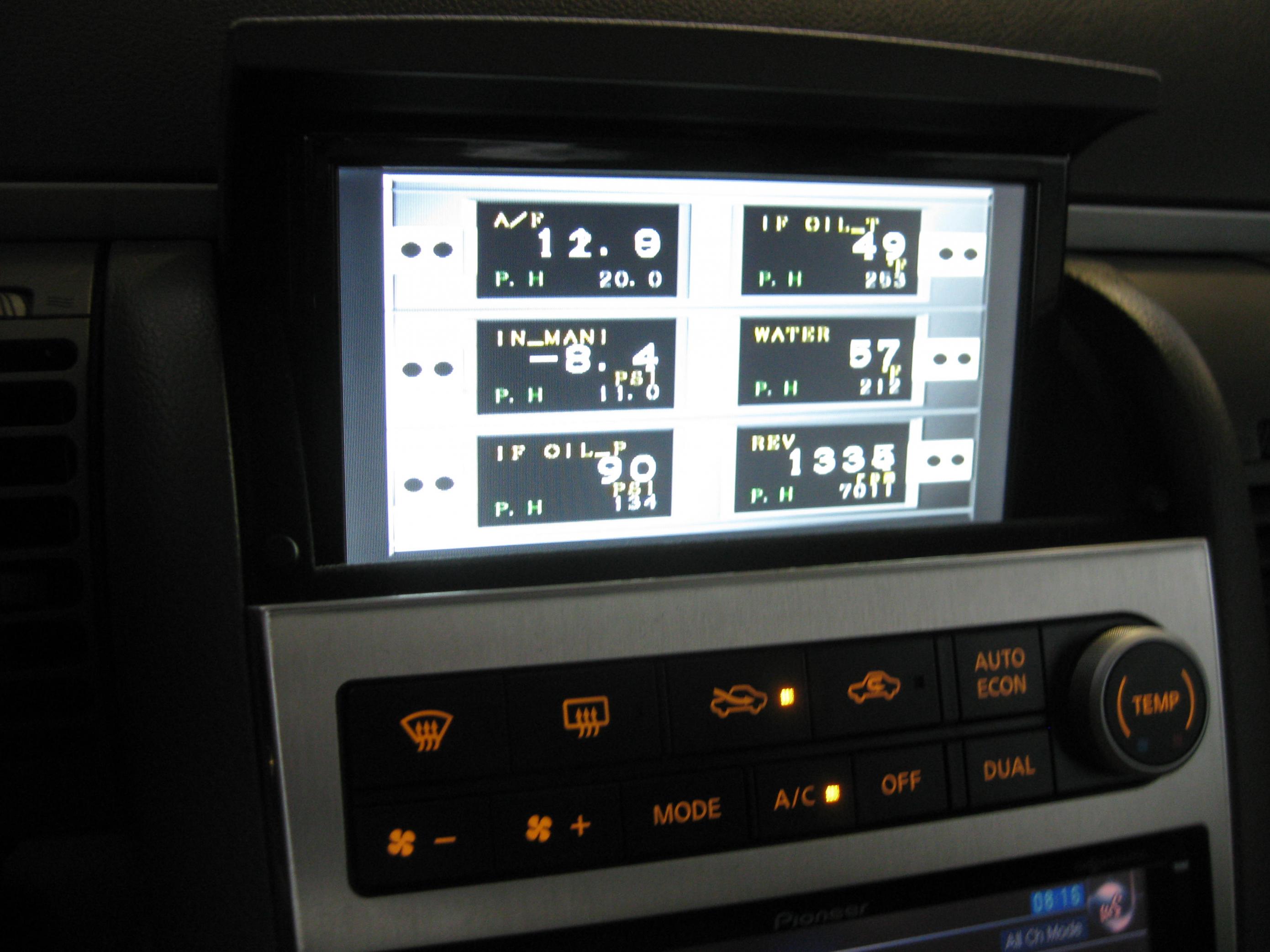

Originally Posted by citymunky
Wrong
You would need the CAMP2 system, the Meter Interface Unit (I/F Unit) to connect to the CAMP2 and the Optional Boost Pressure Sensor and Harness Set to read boost.
Here is my setup, notice how it says IF_Boost.
Actually there is a sensor that reads the manifold pressure that connects to the vpro directly and it reads in_mani on the screen. based on it's location it reads ~.5 psi less than the EVC reading, but it is what the fcon uses to make adjustments...or so I'm told. Bottom line. If you don't have the f-con then you will need Interface unit to read boost on a camp2.

^ the MAP Sensor? In either case I don't think the in_mani displayed any info on my setup. My G has been down for a while so I can't check.
Old Jun 24, 2010 | 07:45 AM
suprasam's Avatar
suprasam
Posts: 498
From: ATL, FT Benning, North Cak
yeah that one. Sharif says he uses that to tune versus the EVC reading because it is directly connected to the Fcon.
Now I feel dumb
