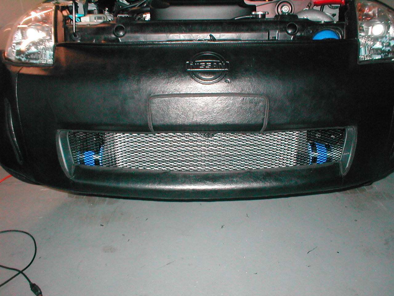

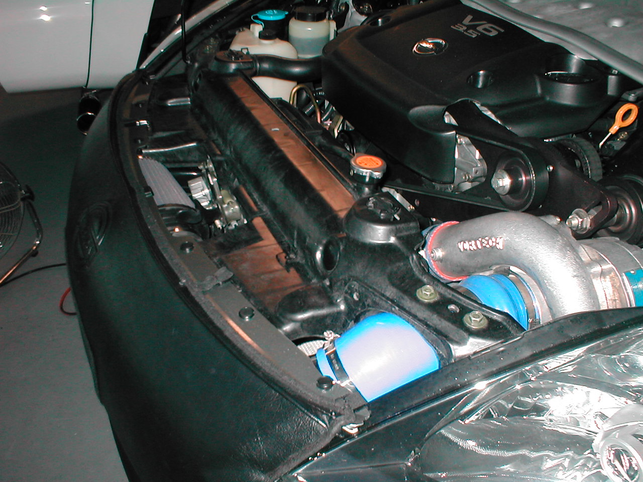

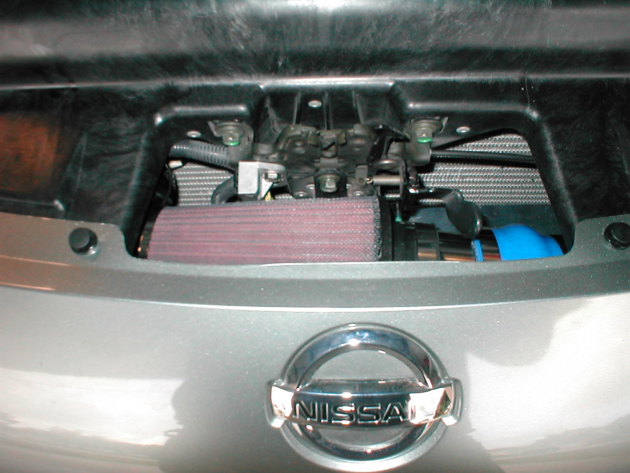

Installed a 4" x 12" x 24" core Intercooler rated @ 1200 CFM behind aluminum crash bar. Also new Intake and Grill.....

Looks good. Like how you mounted the tranny cooler on the crash bar, and added holes underneath to let air into the intercooler.

Nice job and it is brilliant on how you notched out the back side of the crash bar around the intercooler.

Very nice. Any chance I could get that part number for the K&N filter?
Part RP-4630 Product Specifications
Product Style: Round Tapered Universal Air Filter
Base Outside Diameter: 5.5 in (140 mm)
Flange Inside Diameter: 3.5 in (89 mm)
Flange Length: 1.25 in (32 mm)
Flange Type: Centered
Height: 6.5 in (165 mm)
Top Outside Diameter: 4.5 in (114 mm)
Top Style: Carbon Fiber
Top Material/Finish: None
Filter Material: Cotton Gauze
Filter Re-Oiling Amount: 1.15 oz (34 ml)
Weight: 1.3 lb (0.6 kg)
Product Box Length: 6.38 in (162 mm)
Product Box Width: 6.38 in (162 mm)
Product Box Height: 11 in (279 mm)
That's the PS Cooler........

Maybe a stupid question but did u fab up ur own piping for the intercooler?
Old Aug 21, 2010 | 11:53 PM
OldManZ350's Avatar
OldManZ350
Posts: 2,429
Likes: 230
Modified stock vortech 2-1/2" pipe, cut to fit and flared the ends
