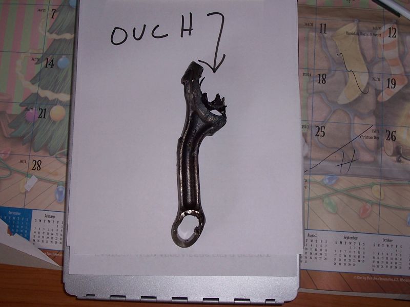

Just posted in another thread but here goes, DE rod after Stillen Stage 4 "hot setup"!!!!
Attached Thumbnails Stillen Stage 2 Supercharger vs Turbonetics Single Turbo Kit-rod.jpg
Old Sep 7, 2010 | 03:43 PM
  #39
djamps's Avatar
djamps
Joined: Dec 2008
Posts: 4,492
Likes: 10
From: MD
Wow... no stock rod is safe LOL
