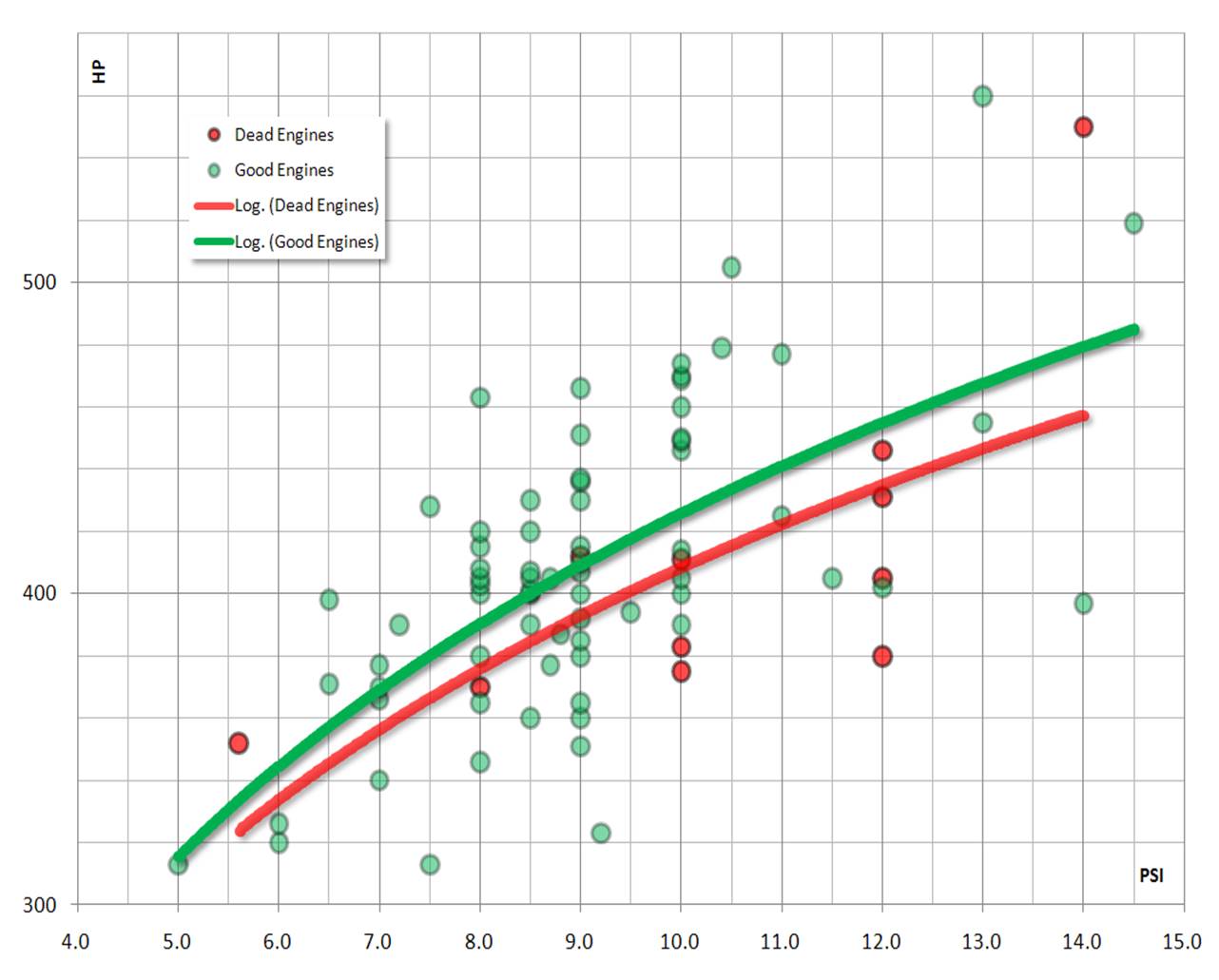

I've been casually looking at FI for a while now and stumbled upon the Stock Motors w/F.I. thread a couple of days ago. There were a lot of respondents and data but it wasn't really organized into any usable format, so I put it all into an Excel spreadsheet. I found some surprising results (for me at least).
The overwhelming predictor for blown stock engines seems to be the ratio of HP/PSI. Between two cars making the same amount of power, the one with higher PSI is much more likely to blow. Based on our data, the magic number seems to be around 42HP per pound of boost. In other words, if your kit is pushing 10 psi, you'd better be making at least 420HP at the wheels. Of course, this is just a wag; there were a few other engines that were relatively boost-efficient that blew as well, though some were attributable to other issues. To get a better idea of the trend, take a look at the attached graph and not the different efficiency lines.
Another surprising result is that a stock engine's tendency to blow isn't really related to the number of boosted miles. If you're doing everything safely FI can be somewhat reliable.
Not so surprising? Superchargers are less likely to blow up a stock engine. Turbo engines blew at a 14% rate while SC engines blew only at a 5% rate.
Download the Excel sheet (zipped) and check it out. Let me know how I can improve it and help make it better by PMing me your own data to fill in the blanks.

Great job. The other (more plausible, imo) conclusion you could derive from the data is that there is no statistical correlation, especially given the small sample size. That's a lot of work to compile - kudos for that.

Excellent job on the graph.

In the s/c vs turbo comparison do you use the same number of each type to get the percentage, or did you take an overall number of messed up engines and got the percentage of s/c vs t/c from there?

The current sample size is 132, 87 of which have PSI & HP data, so the N-number is 87. I ran regression in Excel and got a significance of 78%, correlated maybe but not well enough to draw a firm conclusion. Interestingly, however, if I threw out shaun_walsh's result, the significance jumps to over 97% correlation. I'm sure he's an outlier because his engine finally broke after 100k miles, but I'll leave him in anyway. What we need is more data, so everybody PM me with their numbers!
Overall numbers, which have been revised already. 2 out of 36 superchaged engines blew for a rate of 5.6% and 13 of 95 turbo engines blew for a rate of 13.7%.
One final note about this, everybody remember that this survey data is non-scientific because it is self-reported. Many of the HP numbers are inflated/uncorrected. Blown engines are also likely to be under-reported due to the ego- and wallet-crushing stigma involved. This is all meant to be used a small tool (STS) in your FI decision making.

on what bases you're getting HP/PSI?

Fantastic post! Hope we can keep this graph and spreadsheet going!
My car is making 33whp per pound of boost. 425whp / 360lb @ 13 psi. Does this mean that my set up is risky? Based on the 42whp per pound optimum?
The problem is there's no way to alter the boost level on a supercharged VQ35 car without changing the pulley? Currently have 3:13.
I've only run the car about a 100 miles since boosted.

I think BOTH arguments make sense. According to the data we have so far, peak torque is completely uncorrelated to blowing an engine. The blown engines are spread out evenly across the peak torque board. That doesn't account for where the torque is on the power curve, though, and for how much longer it's produced.
Let me get this right, do supercharger torque curves generally match the stock torque curve, just shifted up on the graph? And do Turbos actually change the shape of the curve to make it fatter down low? Somebody with more SA on this please chime in.
Also, I'd agree that turbos are much more likely to produce out-of-control boost spikes. How much boost can a typical street turbo produce before it's shed off? A metric s***load, I'm sure. The only thing limiting the PSI is a boost controller, and that is reactive in nature. A supercharger only spins as fast as it spins and only makes a particular amount of boost. Seems a lot safer to me...
