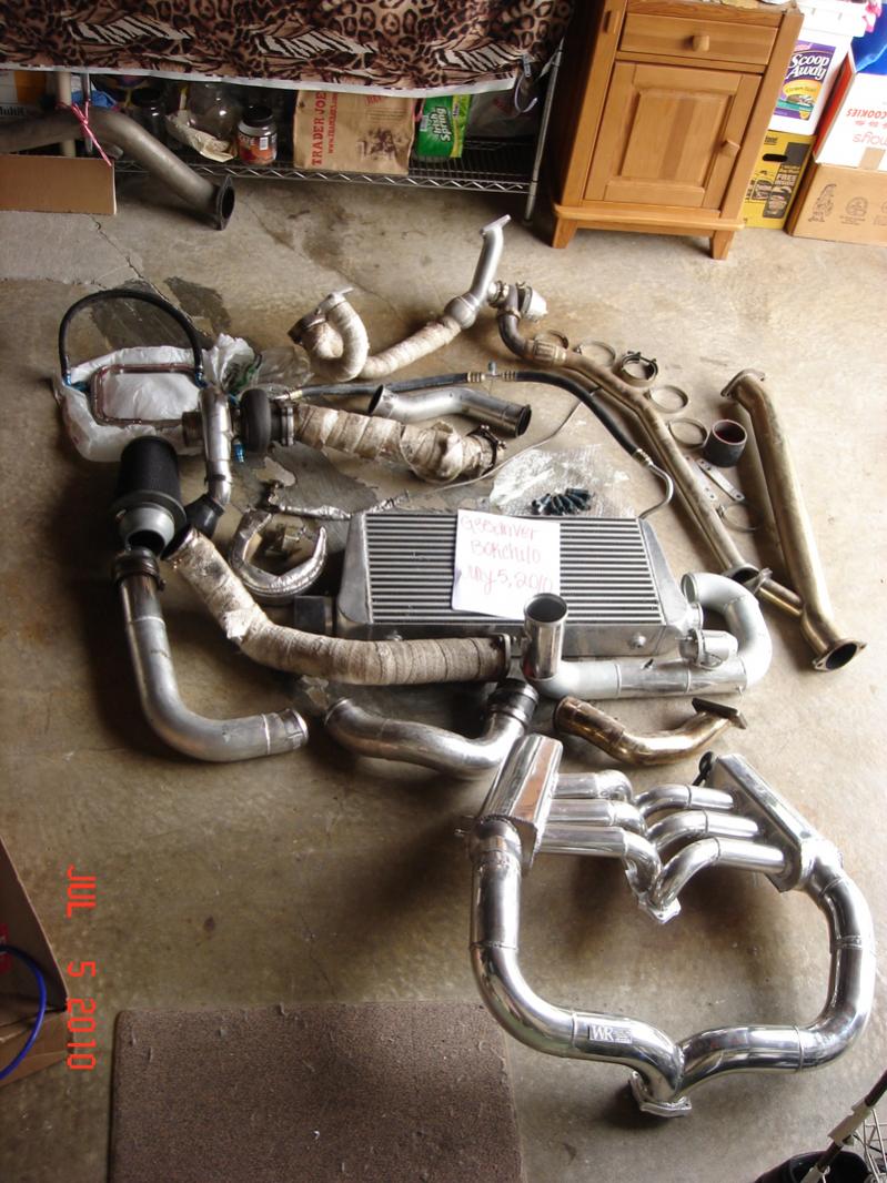

my concern is the exhaust piping in the PowerLab system; i'm not sure if i could install this as a DIY, or if i would need to take it to Intense for the install. I've been searching and searching for undercarriage shots of the sedan vs coupe to compare the differences in exhaust layout, but i'm not having any luck; i've also been searching for undercar shots of the PL kit installed, to see if it's a direct bolt-on for a sedan, or again, if i need to take it to PowerLab for necessary modification.
although i won't mind taking it to them, i'd really want to gain the experience regarding the installation.
as i said, i spent about 20 minutes on the phone with them yesterday, but they acknowledged no experience regarding sedans.
Attached Thumbnails F/I, G35 sedan and clearance question-plab_2.jpg   F/I, G35 sedan and clearance question-ntnsracing_2121_164320932.jpg

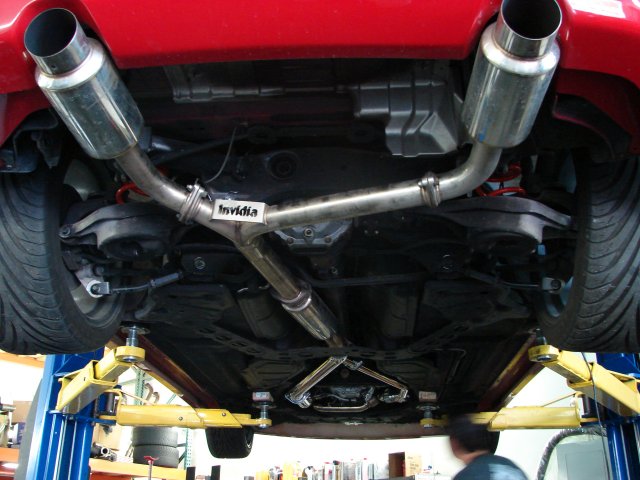

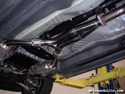

OK, well I found these three images after 2 hours of searching the web, LOL. It does look like the PL kit replaces the factory Y-pipe; and Y's appear the same between the PL 350z (left) and the Tanabe Y-pipe on the sedan (right). The third photo is another y-pipe from another sedan (i'm assuming this one is stock) Am I correct?
And again, assuming I am correct, the diameter of the piping throughout the kit itself will fit a sedan, since it shares the same bay as a coupe?
