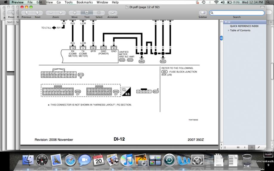

Guys,
Does anyone have a diagram of the 07 ECU? I had installed a Blitz SBC i-color boost controller, and I'm having problems locating the speed sensor wire on the ECU.
I have everything functioning BUT that..PITA
thanks in advance

There's a speed sensor wire that goes to the white A/C control box behind the shifter console. I forgot exactly which one it is but do some research on it and you should be able to find it. I used it with my HKS EVC VI.

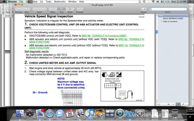

It's pin 26 on connector m49 on the white a/c control box.
Attached Thumbnails ECU question-screen-shot-2010-10-20-at-12.35.05-pm.jpg   ECU question-screen-shot-2010-10-20-at-12.35.28-pm.jpg

Thanks. I'm having my Emanage tapped into this as well to run the 2 step.
This is the right one.
