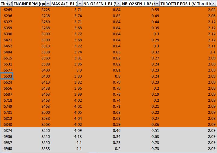

Alright I've did some data logging. Found out that bank 1&2 is leaning out one after the other around the said rpms. Mine Z is a 2003 so I have no wideband as standard. All this while I am relying the AFR from LC-1. Do I have a bad O2 sensor or is it anything worse. This only happen at part throttle. Everything is fine when I go full throttle. Please help
It is normal to see the voltage from a narrowband bouncing back and forth (at least from my experience).
