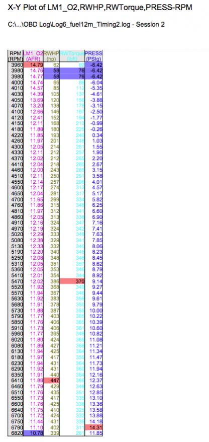

This is the last Dyno I did back in Feb of 2010, the other Dyno at start of thread was an older one. Not much difference, a little leaner in the upper rpm.
Like I said, anything is relative, as you can see this one is 1/2 lb Less Boost with More HP and TQ. No mechanical changes on car.
I've made some changes late last year, larger intercooler, ect, No Dyno yet...
