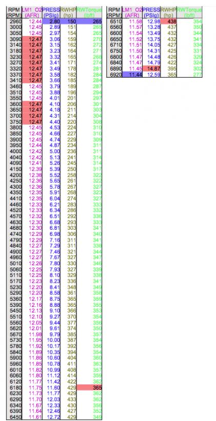

Default WHO SAID CAN'T get Flat AFR'S a Vortech FMU
Attached is a Log of AFR'S, is this Flat?
What do you Think Tim.......?
Vortech, Walbro, 440cc, FMU, 2.87, 32/28 Conservative Street Tune by TimRod Engineering

great numbers man, thanks for posting
what program was used to record that data?

Your A/F ratio looks pretty good and consistent.
Were these logged on a Dynojet?
At the tail pipe or bung pre cat?

Innovate WideBand, No cats but installed in that area.

Looks good!

Nice numbers. I do see that you have >12 AFRS till mid 5k rpms and around boost of 9. Isn't that a bit dangerous on the engine? Obviously your running great on your stock engine.

no. 11.8-12.1 is perfect for power and safety. anything richer is leaving power on the table.
