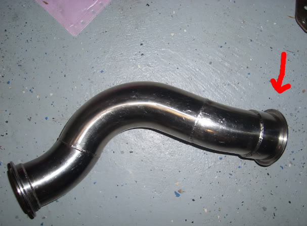

OK...need help fellas. i'm trying to install the middle up-pipe, and can't get it through. It looks like the 4-bolt flange is hitting the heat shields on the headers. Do these need to be removed, or am I just a bumbling moron?
rraaaggggeeee
EDIT:
after an hour of searching teh intranetz, i realized i was using the wrong piping for the mid up-pipe....FML
found the right piping, but still couldn't get it to fit the way it was supposed to. Went back to the pictures i previously found, and realized the stock exhaust manifolds have a heat shield on my car, which was A) not found on the other installs, and B) was never mentioned to be removed on the PowerLab instructions.l
took those off, and was able to get the piping in, but now it's hitting the steering column. gonna probably do a big of hammer massaging in the morning to avoid any rubbing, and get the clearance I need. Looks like i only need about 1/4 to 1/2" of additional clearance.

Maybe it's me I'm not sure. No many how many times we tried, the piping was hitting the shields. As soon as I removed it, I was able to get the pipe to fit. But now it hits the steering column. Gonna probably use a hammer for some adjustments if I can't get it to sit properly

no dont use a hammer lol. Is it hitting the coupler?? Some kits need the coupler to be swapped out for clearance like the GTM kit.

I'll have to upload a picture. But it's the actual pipe that's hitting. If you've seen the middle up pipe, it's where one of The bends is.

well im close to throwing tools are there differences in the steering rack between G sedans vs coupes? or am i just a bloody idiot hahaha?

There is a difference in steering rack from rev up and non rev up. Find out if your kit was for a rev up motor.... BTW u didn't let me know if u got rid of that hydra. There are different up pipes for rev up n non rev up.

The guy who I bought the kit from said it was for a rev-up coupe. But no matter how many times I rotate the piping and/or try different angles in bringing up the piping, a certain section always contacts the steering knuckle. even if i were to hypothetically "massage" that center section jsut to simply fit, i'm sure i'd encounter some serious rubbing.
i don't have a picture of it yet, but compared to the photo i posted, the left section of the piping is different; on this posted photo there appears to be a distinct curve present. the piping i have is just a straight section, with the same curve thats present on the right of the photo. is this the difference you're talking about between revup vs non-revup motors?
