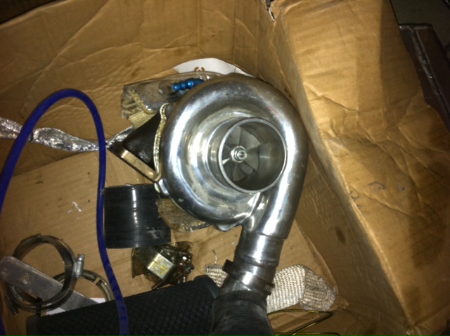

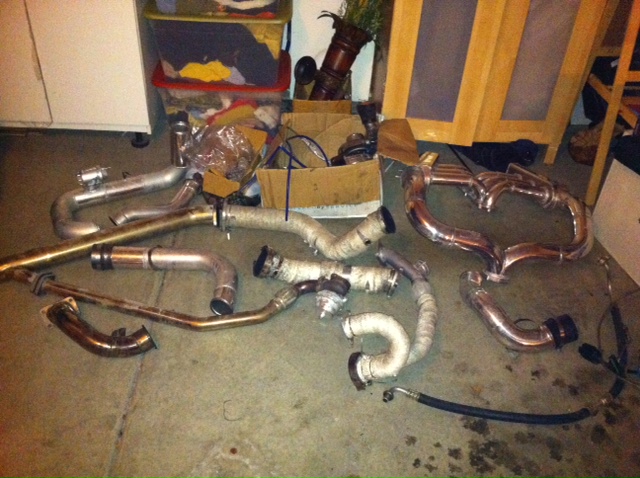

and quite a few dreamer threads, i'm finally about to begin my FI project
My goals for this are really mild (no more than 450-475rwhp) as this is a sedan that hauls my kids around on occassion. That being said, I found a pretty good deal on a used Powerlab kit w/ custom intake manifold, HKS blow off valve, turbo blanket, some heat wrap, and a Hydra EMS (which I'll be posting for sale tomorrow, once I take appropriate pictures). This is going to be the first A) time doing any sort of wrenching on my car, and B) doing any FI, so I will probably need your help during this process. I'm looking at starting the install within the next 2 weeks.
See, I failed when I went up to pick up the kit in SF (made a weekend trip out of it). On the way home, I left the intercooler behind
either way, he said he's going to ship it out to me this week.

My brother and I installed my PowerLab 35R kit in about 3 days in a standard 2 car garage with nothing more than basic tools and a few jacks from Harbor Freight. I picked up the kit brand new from a local guy that never got around to installing it on his 350Z (he sold his Z and bought a G37). Couldn’t be happier with this kit, made 360 whp on 4.5 psi (boost controller’s getting installed this week though… ). Looking forward to seeing your build!
I’d also look into Jet Hot coating the exhaust piping too; it made a very noticeable difference on my car.

I believe he did jet coat all The piping. At least that's what he told me....is there something I should pay attention to in ordertl verify he did that? How much experience did you have wrenching prior to installing this kit? As I said before, I had no experience beyond coilover installation
Well, I can’t really tell from the pictures you posted, but according to Jet Hot you’re not supposed to wrap the piping once it’s coated. But you should be able to tell if it’s coated by just looking at piping, it should be silver and there shouldn’t be any discoloring/burn look on the piping. Take a look at my build thread; I have some pics of the kit before I installed it.
I personally didn’t have much experience wrenching, my brother’s installed turbo kits before and he helped me out, but overall it wasn’t a terribly difficult ordeal, just take your time and make sure you have everything you need for the install. Also, I recommend getting a friend who has some experience to help out though.
