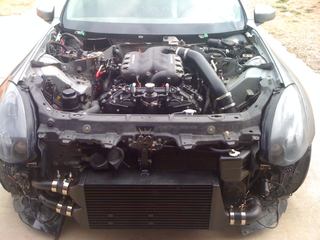

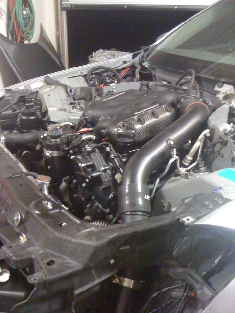

Just finished putting my car back together. She starts and idles fine, no codes thrown with the stock ecu.
Here is a brief mod list:
2004 G35
CP 8.5 pistons
eagle rods
IP billet girdle
revup oil pump
hks head gasket
arp l19 head studs
arp main studs
brian crower valvetrain
brian crower stage 3 cams
ATI crank pulley
aam oil spacer
DXD 6 puck sprung clutch
DXD steel flywheel
koyo 54mm radiator
gtm fan shroud
Cosworth intake manifold
CJM twin pump
aeromotive AFPR
return fuel system
Greddy TT kit with forced performance upgraded 76 comp, 67 turb
38mm tial wastegates (14psi) with open dumps
3" custom downpipes portmatch for turbine outlet with 3" exhaust cutouts (SP eng boost acquated cutouts)
greddy evo tt exhaust
quaife lsd with 3.3 gears
IP diff brace
solid motor mounts and urethane trans mount
thats pretty much it. I am currently running on the stock ecu and injectors. I just wanted to know if there is anything I should be worried about with these engine vitals:
I've got a wideband sensor in each downpipe about 6 from the turbine outlet and am currently seeing the a/f ratio fluctuate between 13.6-15.6 on the drivers bank and 13.8-16.1 on the passenger side, if i hold the revs up to 3k it stays pretty solid at 14.1-14.2. I have been told it may be because of the cams and the stock ecu trying to adjust A/F for it.
some other stats, Fuel Pres. is steady at 52 psi, oil pressure is good, vacuum at idle is right around 18-20, egt sensor is in passenger side bank 2-3 inches from turbine outlet and reads 600 degrees at idle, goes up to 1000 while driving around the neighborhood, but drops back down to 600 after a couple of minutes, water and oil temps are similar to stock. The clutch is a PITA. It is either on or off.
I am also running torco breakin oil sae 40 weight for now, I plan to go to plain ole castrol gtx 10 w40 after the 500 miles. I would really like to break the motor in with the stock ecu and leave the charge pipe dissconnected with a filter on the MAF to prevent going into boost, but am willing to tow it somewhere to have a shop go over everything.
Still contemplating on the tuning, I've got 3 options:
1. I have a used utec with 750 cc injectors, that already has been tuned for the greddy tt kit by Chris Macellaro in dallas, run that for the base tune and take it back to him for a tune for my car.
2. sell the utec and head to austin for an uprev tune.
3. sell the utec and purchase a haltech and have Jtran tune it in houston.
Money isn't a problem, but I don't want to spend it if I don't have to, only looking for 500-550 for now and if the utec or uprev will be fine for that level, then I don't want to spend the money for the haltech, until I decide to turn up the boost. Has anybody had a problem breaking in their built motor with the stock ECU and these cams?
Here are a couple of crappy pics. I'll have better ones, once everything gets sorted out and tuned.

I would think with the BC3 and low compression you would have some issues with idle for sure. nice setup btw! DIY build thread pics?
Nice use of the t-bolt clamps. You should pick up the treadstone maf pipe to eliminate the oem plastic tube. I posted a link in a thread I started on here.
I would suggest using the utec to make sure your fueling is good. I just dropped in my 800cc injectors and started running off my haltech tuning the fueling/VE. Run your AC so that the idle is bumped up a bit too and maybe get a reflash to up the target idle.
