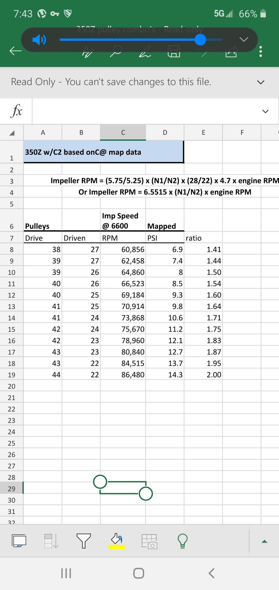

I know this is old but if anyone come s looking for pulley boost ratios
