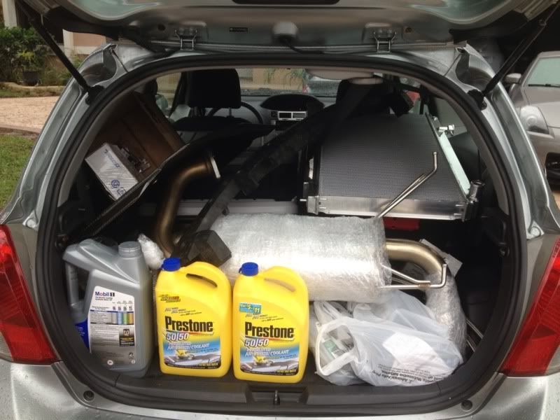

let the madness begin
The all mighty Yaris!!!
