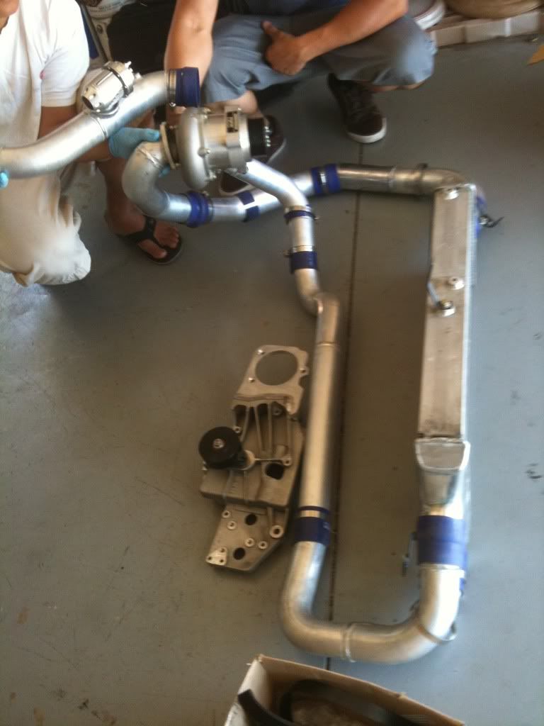

Sorry it took so long for the pics flo-rida z33 but here's the pic you asked for
Thanks brother... that's actually the perfect shot and the one I was looking for. For those interested... The HKS8550 kit that Crtan77 bought has a Type-S Intercooler(Core P/N 17300-272287, not sure of the end tanks).
For those asking about the pulley upgrade interchangeability between the early Rotrex C30-94 and HKS7404... they're not the same. The Rotrex has a 7-rib pulley with a beveled bolt and the HKS7404 has a 8-rib pulley with an allen bolt. Now I've heard of an upgraded pulley bolt but I'm not sure if that applies to my particular kit.

Nice pic of the setup. Just an fyi you have the piping a little wrong on the compressor but I am sure once you install it, it will fall in place.
