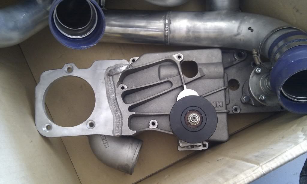

Flo-rida ...Here's the pick of the modded bracket to fit the larger sc http://i836.photobucket.com/albums/z...7/IMAG0147.jpg

Thanks for the pic... it seems like they added a CNC machined piece that matched the size of the 8505. I wonder if the pulley idler is the same size as mine.

To answer your previous question. I'm going to be using a non jackshaft bracket.
I was looking at the GTM upgrade for the HKS kit and it's only a pulley upgrade. Why not just buy the rotrex one in case the mounting is different? http://www.urdusa.com/Forced-Inducti...veau88eb8m11r2
This is what you were looking at right?
http://www.gtmotorsports.com/product...cat=258&page=1
I think the 8550 bracket is a combination of machining the compressor mount hole to be larger as well as extending it hence the weld spots.

I'm currently overseas so my plans to have it installed would be sometime in November. Thanks for the info for the Rotrex pulley as it seems logical to go that route. I'm willing to bet the pulley's are the same but the internal specs may be different between the units. I'd actually be interested to see what results I get with this system compared to the 7404, I just hate the idea of doing all this work to get marginal gains from a "downgraded" Rotrex C30 when I can pay about the same for a HKS7404 and pretty much do better for the same price.
The thing that gets me is, why did HKS switch from the C30 to their own 7404? Was it a durability thing? Was it flow thing? At the moment I'll just pick up the 90mm pulley and GTM's intake system. After seeing the C30/7404 histories I'm hoping to see a realistic 350whp/330tq at the dyno with the upgrades. If for whatever reason it blows up... then I'm doing a rebuild and adding a 8404.
